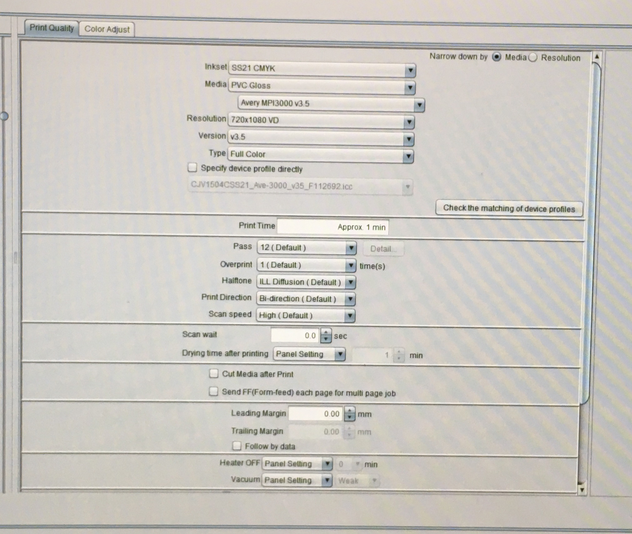

Hello Signs101 Community,
First post here!
- Running a Mimaki CJV150 with SS21 Inks using Rasterlink6 Ver 5.16.
- Printing on Avery MPI1105SC and MPI12903
I’m new to digital printing and curious to see how everyone achieves nice greys in their printing. I’m finding that my greys are either green or a muddy colour.
- Is it something as simple as a profile in Rasterlink? The profile we are using is CJV1504CSS21_Ave-3000_v35_F112692.icc
- Could it be more complex like colour management and understanding of colour theory? I have just started playing around with the ‘Colour Adjust’ dropping the Cyan, Magenta and Yellow values but still couldn’t come up with satisfactory result. (Picture attached is typical print settings)
- Or is it the process of printing from illustrator to Rasterlink? When in illustrator and ready to print, I usually just click on print, select the printer (CJV150) which drops it into Rasterlink. I did find that when I hit print in Illustrator and clicked on the ‘Colour Management’ tab, the document profile is U.S Web Coated (SWOP) v2 and the ‘Printer Profile’ has sRGB IEC61966-2.1 automatically selected, I did try changing it to U.S Webcoated but I don’t think it made much of a difference.
I’d appreciate any comments, feedback or just a nudge in the right direction either links, YouTubers, tutorials, etc as I would love to learn more about this software and machine.
Thanks!

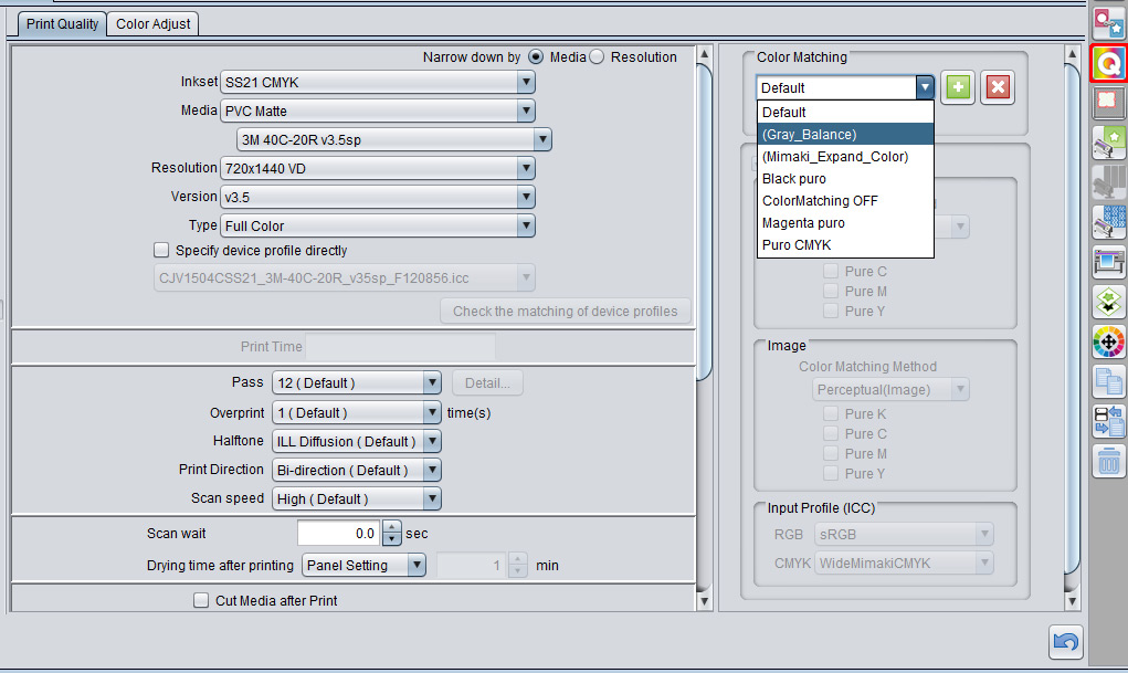

Lady Who
Hello there!
Try selecting the Gray Balance option in the Color Matching section, on the Quality menu for all jobs containing greys. That always worked for me when the greys were brownish.
Not likely. However, it’s easy to check if an ICC output profile was generated when a color printer was calibrated to grey. Open your printer quality evaluation file in your design software and temporarily softproof the image using the ICC output profile in question. If the greys change, the printer was not calibrated to gray.
