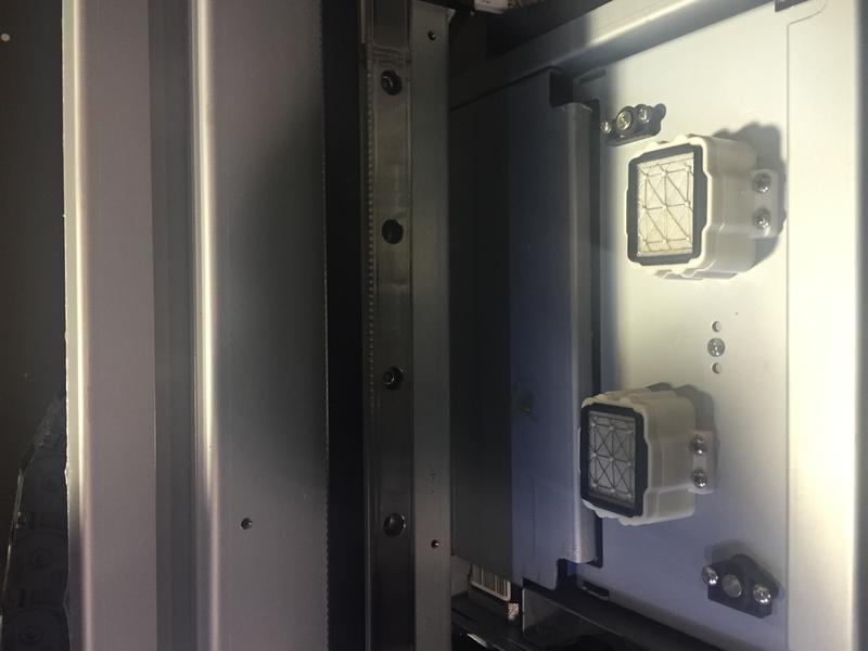

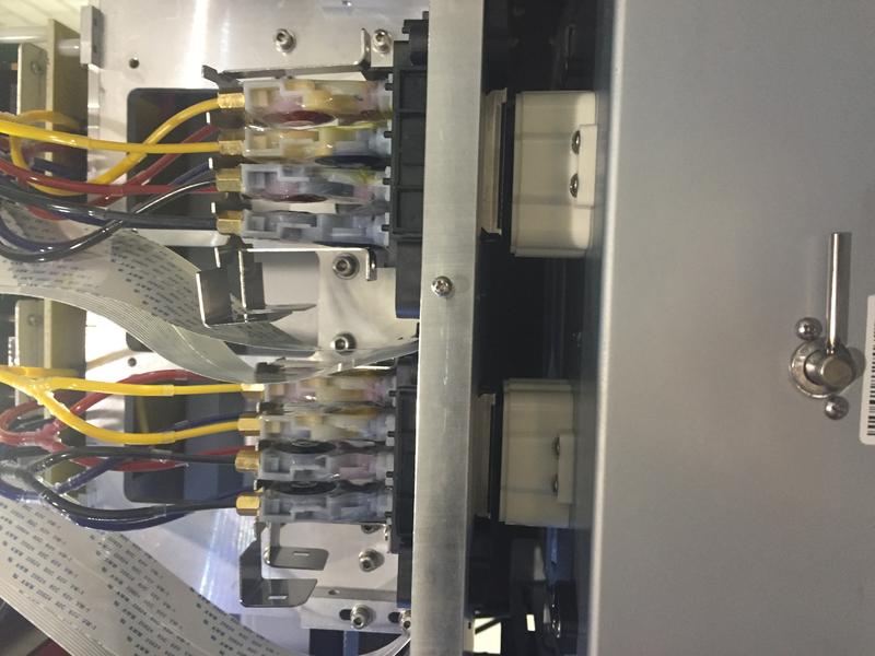

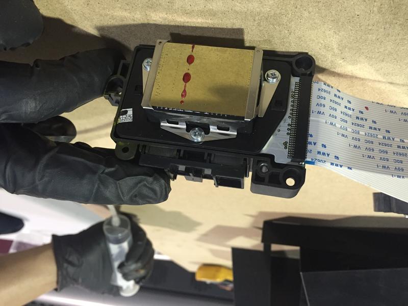

I just received a printer from WitColor that has 2 dx7 heads. Printer driver is all installed and ready to go, but the heads won't release any inks. I see that the inks are all loaded up to the nozzle, but the capping is not damped nor the heads. I removed the heads and tried to pump the inks by the syringe, and it worked by that way. I think there is a connection error or the printer is not detecting the heads, but I can't be sure. Did anyone have same problem?

When you pushed ink through with the syringe, did it print anything? Even a couple nozzles? Once ink has gone through the head, you should be able to get at least something to print. If not, it could be an electrical issue. The fact that the cap tops are dry is really confusing. How did you fill the ink line and dampers in the first place? You must have done it manually with the syringe or something. To me you either have an electrical issue or the cap tops/pumps are malfunctioning.

I manually pulled out the ink by syringe, and could see that the ink was not dried. I contacted with the Chinese manufacturer yesterday for a few hours and I found out that the only problem I had was that capping and head was not 100% accurately aligned. Only a little bit of head position adjustment was needed to suck out the ink from the damper!
