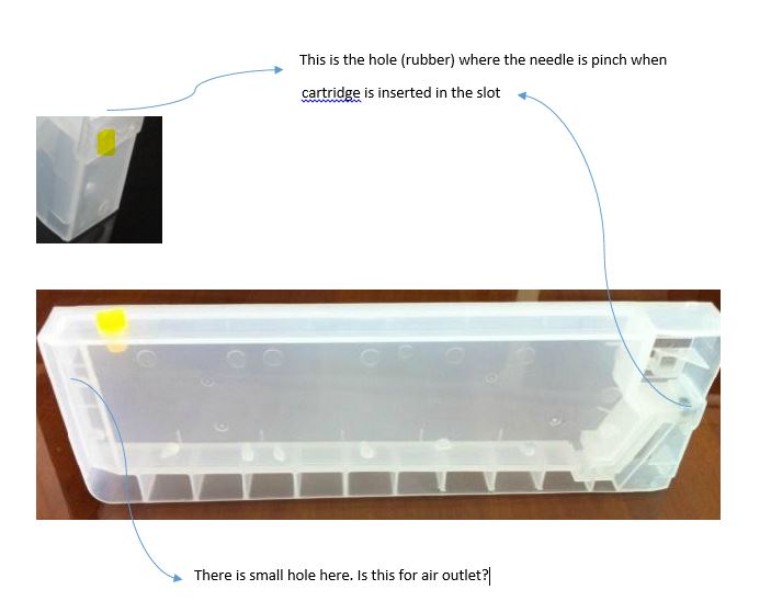

hello umca, nice support. will try your input. and give you feedback on the outcome. so if there is an air leak, no ink will flow from cartridge to the ink tube before the valve. what is the use of the small hole at the back of the cartridge as shown in the picture below. is it for air. how can i replace the rubber cork in the cartridge, is there a replacement part for it? can i swap the rubber cork from my K (black) cartridge to the C,M.Y cartridge just to test if it works. Note that the K cartridge is working, the ink flows when I insert it to all ink slots. thanks

Small hole on back side of cartridge - for supply air into the cartridge for impossible to create a vacuum inside. Always should be clean and open.
Yes, you can swap cork.
