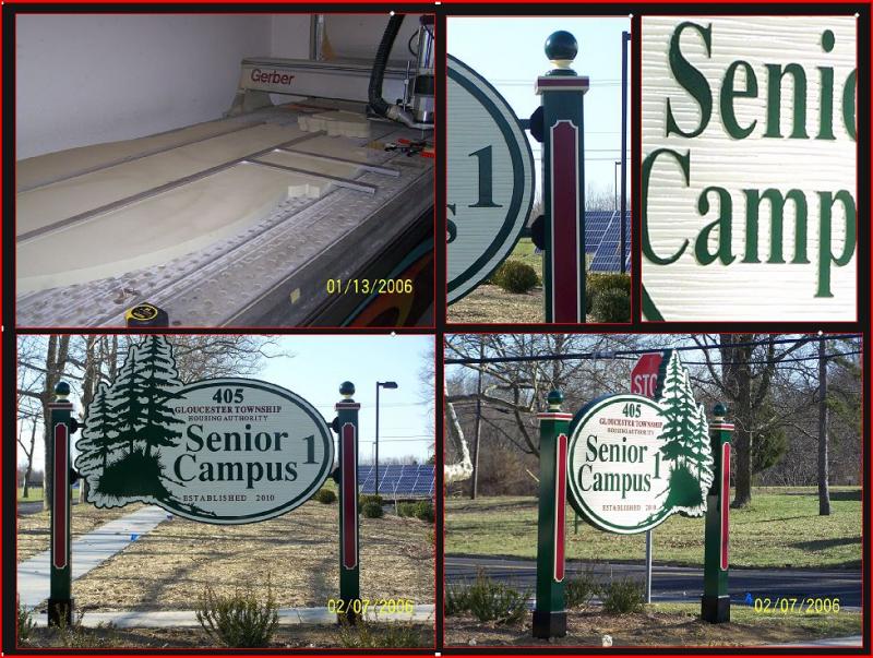

Did my first new sign with new enroute 4 software and love it no more masking and sandblasting what a time saver No more lifting 100LB bags:beer

Wow Ed, that is a nice sign. Could you give us some more information on the sign?
How deep is the area around the letters? It really looks like sandblasted redwood.
How big is the sign?

I'm using Vectrix Aspire software to create the same thing. It's a nice effect in HDU and PVC but I still prefer the look of real wood so when I have to use real wood, I'll still do the occasional blast but it has it's place when carving synthetic materials.
Nice job btw.

The sign is 62"x80" two 1 1\2" thick 20lb hdu glued to 3\4x1.1\2 Aluminum supports.Mounted to 6"x6" aluminum post with hdu tops and trim All paint is automotive paint SEM high build primer.u-tech 3.8 polyurethane and oneshot paint.The texture has highs and lows of 1\2" .The letters are raised a1\4" off the highest point of the background texture. By importing bmp. into software You can make all kinds of texture and save for other jobs.My mined is spining on What I will do next

It took 6 1\2 hr per side as to 3hr of masking & blasting per side the old way. But I can go and do something other while its working:beer

We've been doing similar routing on 4' x 8' PVC sheets, bonding two together back-to-back to form a double sided sign. These are typically text and numerous governmental logos for parks and projects. I'm using Enroute 3 and am looking forward to upgrading to version 4 for the textures.
The time to route PVC isn't so bad. We cut at 168 inches per minute, using a 0.250 bit. to give the job a uniform depth and bit width. Then, we go down into 0.125 and 0.0625 at much slower speeds for detail passes. If we upgrade to Enroute 4 and put a texture on the background, I'd be able to use a larger bit to cut the field (like a 3/8" or 1/2") at a significantly higher speed, since the texture would blend out the widths of strokes.
