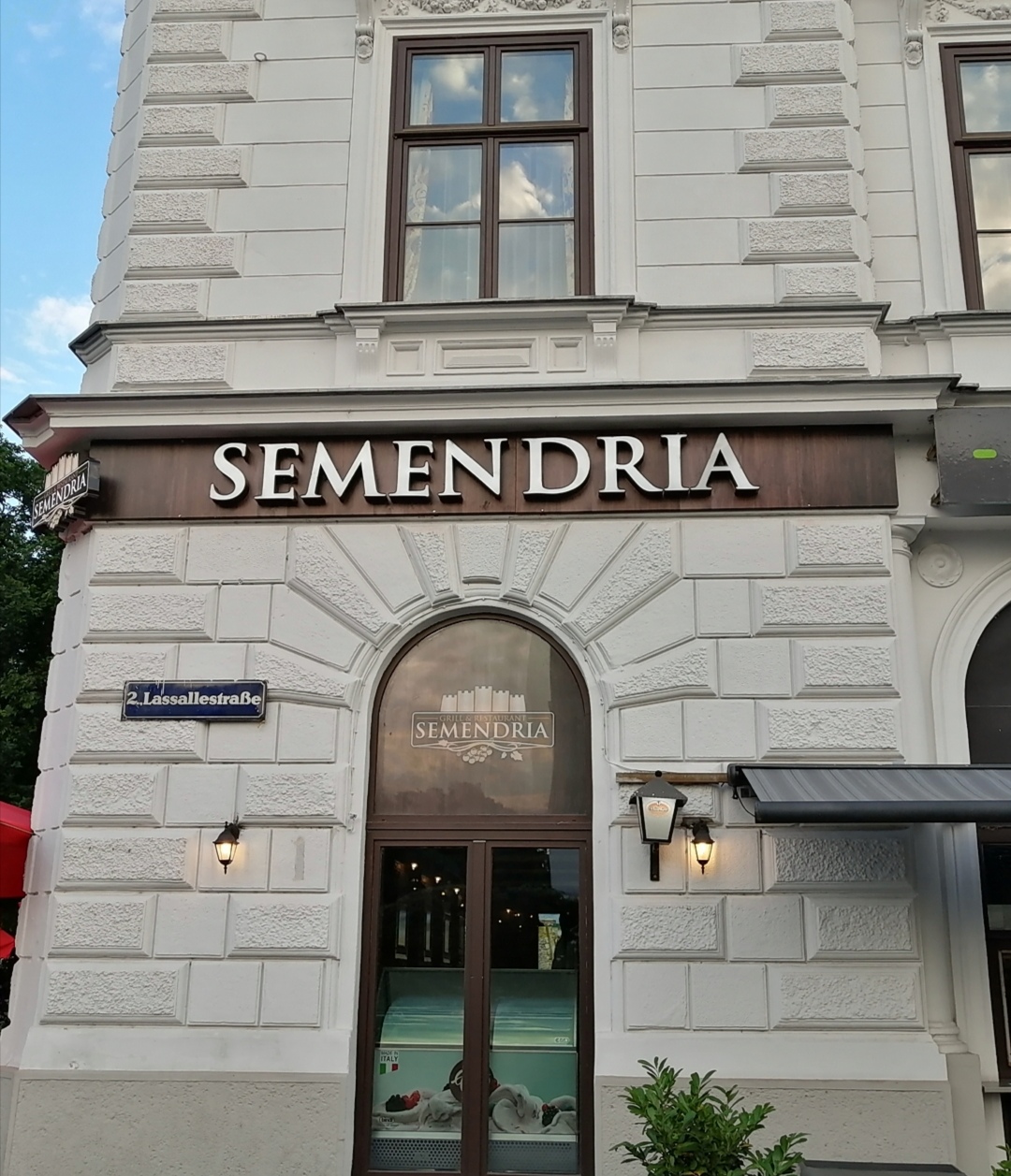

Floridaman
How come they didn't notice that both letters E are...mirrored? Having the logo a few feet under as a reference
James Burke
I can understand an occasional installation oopsie with flat dimensional letters, but this had to be totally botched starting with the design process with the mirrored returns AND faces.
The kerning is wonky as well.

Val47
Boudica@Nite
I'm thinking: pissed off designer making a joke that didn't get caught
Or... Young executive, wanting to take the design outside the box. But they only had control on the big sign project.

Jester1167
The fabrications guys were in a hurry and put the backs on the wrong side of the can. Someone towards the end noticed it, but because of the deadline and costs to remake it, they pushed it through hoping the customer wouldn't notice... The customer never mentioned it so they moved on to the next pressing deadline.
James Burke
I thought that at first but...doesn't the can have a rolled lip / edge (to retain the face)? I'm no expert whatsoever but it's definitely not a sharp edge.

JBurton
Signtologist
If they were regular channel letters, then yes, you can totally flip the return and the back and make the letter backward. If it was coming off an accubend, you'd have to try really hard to get the return to fit, but it's possible since there are no hard edges on the edges of the letter. If the back and the letter were routed, then hand formed, and the guy laying out the sheets flipped some of the letters to maximize space, then the fab guy probably left the film on the letter so he would know what is back vs face, and formed the return to fit.
I'm leaning towards pissed off designer/fabricator's last day!
