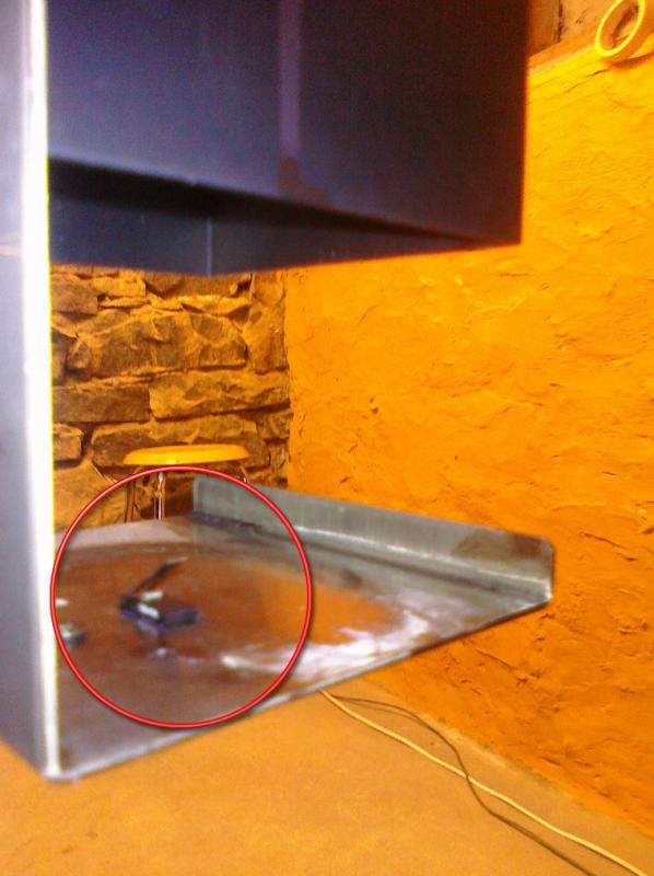

This is a photo (not very good...) of the switch. I don't know if this gives you guys any better idea of what I am working with.
Thanks!
