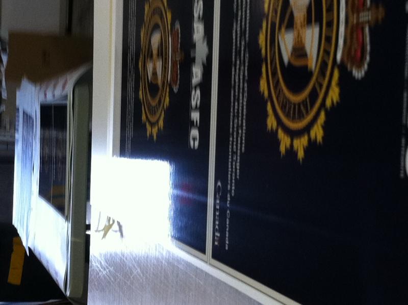

I have a large job to do and a fair bit is due tomorrow morning. I printed everything pristine and high quality. I came in saturday night to laminate it all so that it would be ready to go this morning. Now as I laminate the prints to pvc I can see in the laminate these lines that you can find sometimes in vinyls like a continual rub. The lam is gloss and in the light these are pretty noticeable to me.

I had a roll that had that.. went away after a bit though. I could see where the lam was sticking to spots on the backing paper and pulling the adhesive a little.

Sounds like temporary deglossing called mottling. It goes away when the sun or any heat source works on it for a few days. Been around for years and, I can only assume, the manufacturers have no means to prevent it ... or they would. It is only a problem in terms of the customer noticing it when the work is first seen.

I thought about modeling and hit it with a heat gun but still it is there.
here is a pic, you can see it.
what burns my azz is that it is us, the final stage of completing a sign that has to deal with it. You think if i call my supplier they will do anything to compensate me? How about the mfg? The sole purpose of a laminate is to cover something and be free of irregularities. Worst of all is that you cant detect it when it is on the backing paper.
