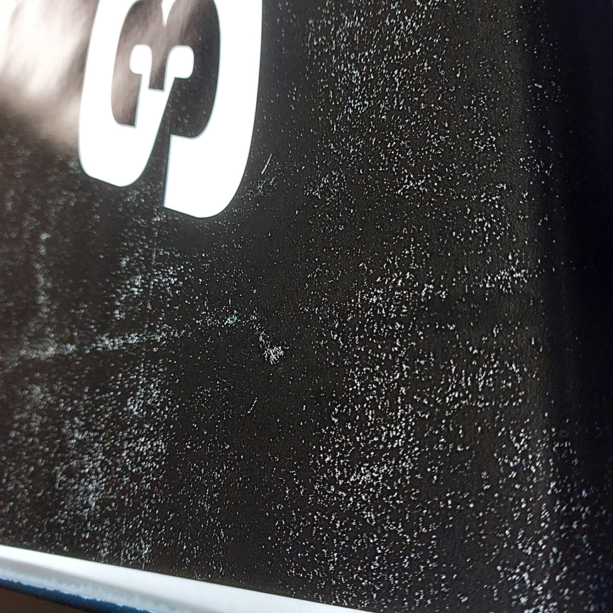

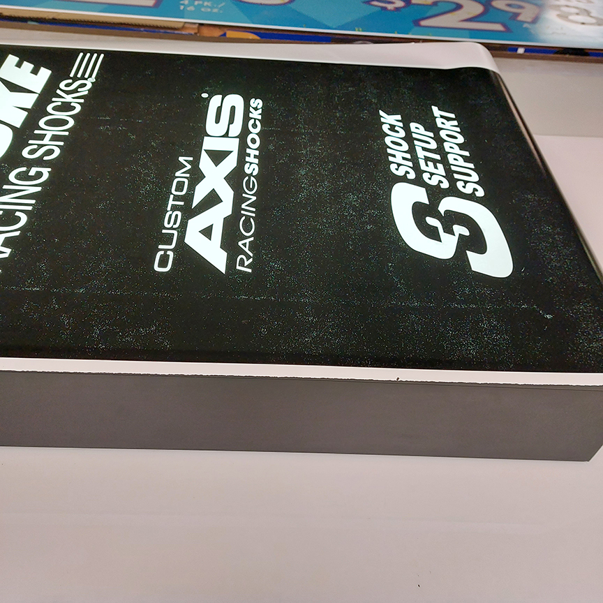

Two samples below are printed on oracal 3850 translucent stock and printed on 3 pass with a roland 540 cmyk. The one picture is the camera about 6" away and the other is about a foot away. LEDs are inside the 20" x 30" box.

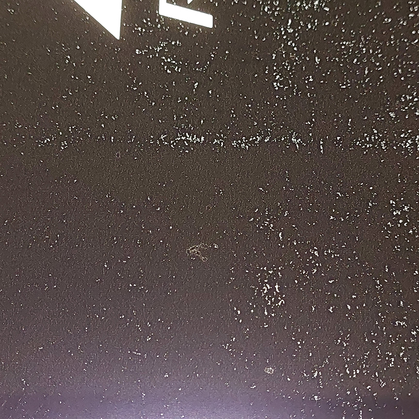

Not shown is the first panel we printed at 2 pass and it had a slight bit of these dots down the very middle of the panel. Thought it was contaminated. Last print with that roll was about 3 or 4 weeks ago and everything was 100%. These don't show up until ya turn the lights on. These dots were completely on the entire surface. You cannot feel them....... anyway I can't feel them. Both times the vinyl was wiped down with alcohol before printing.

Now, here's a picture a bit further out. You can't feel a thing before or after printing. I'm almost 100" into the roll now, so it's literally been untouched by any hands that I know of. penskbottom half.jpg

i have seen this with the white ink when i would do multiple pass and the previous pass was not dry yet
maybe it's just too much ink and that's the effect?

What happens on one or two pass? You sure you aren't dumping too much ink?

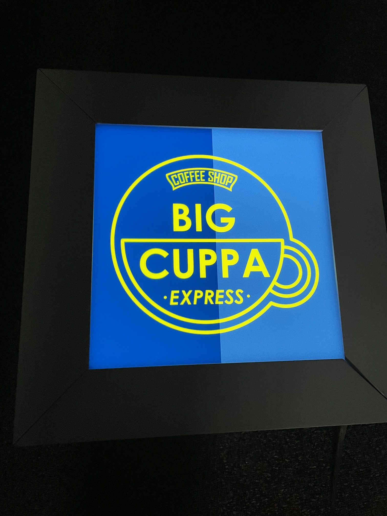

As far as laying two pieces of clear, it's usually pretty easy, but you need to do both in the same fashion, so if you're laminating, laminate both, even better if you can run them side by side. Here I have two prints aligned, stupid small copy at this scale, lining it up is easier than you'd think. The size of the cabinet is 12" square for reference. If I zoom on this image, I can see misalignment, irl it looks fine.

Frankly, are you sure this isn't in the print? It looks kinda plainly distressed. Like it's going real fast! Vrrroom! Just make sure when you tell your customer, you have your favorite cohort behind you making the vroom sound, even better if he throws a turbo whistle in there too.

Looks like too much ink on a non receptive surface to me. How the heck do you get decent 2 pass prints on that Roland? I had to run 6-8 minimum.

I've had this happen years ago, printing on Avery clear with an Epson S80600. I was printing large pieces in reverse, laminated on white, and used for the Harmon Kardon storefront on 51st & Madison Ave in NYC, paneled for multiple 10'H x 18'W window. After printing the first 10 feet with a 12 pass, the ink would start looking like it had been rained on with alcohol droplets. I laminated 20 feet before noticing the problem. I tried a second roll and the same thing occurred. Next, drove to the warehouse, bought another roll of the material, and again the same thing. The material was close to a year old in the warehouse and I wondered if that was the case. I would up printing first surface on white window cling in large panels, hand-cutting it and completing the installation from Hell overnight in the city.
I never had luck with anything over 2 pass as the ink was just too heavy on the SP540v. Check the material first for age, I'd probably try a different roll before looking into the printer itself.

unfortunately these crazy unexplained things happen but it sounds like it's a drying or curing issue with the ink (or the amount of ink). maybe try doing 1 pass, return to origin, let it dry a little longer then print again with 1 pass. see if that helps/works. hope you get it worked out
ChaseO
When I have similar issues, its either not enough heat or old vinyl. I got a roll from one of my suppliers that ended up being 5 years old. Sometimes rolls get pushed to the back. I use a ton of oracal, but I have pretty much stopped using 3850.
