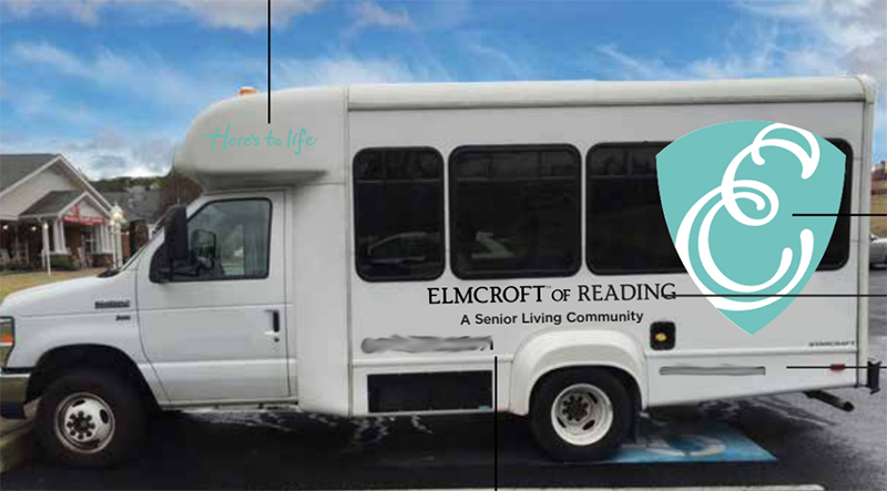

We have another sign shop wanting us to do some work for them. They said, they've done quite a few of these and everyone else puts the vinyl on the window seams. We never put it on the black rubbery/plastic part, as it usually doesn't hold very long.
Opinions or input either way would be appreciated. They said they'll think about it. No big deal, I just thought that was kinda industry standard.

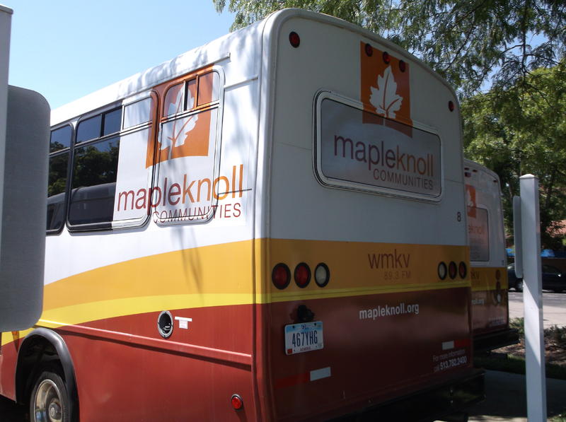

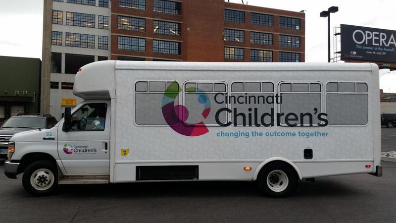

We actually put it on all the time, when it has to match an existing bus with it on the trim... which happens to be most of the time unfortunately.
We use 3M 180c and it does hold up well. We tried Avery and a couple other wrap vinyls a couple times and they all fell off really quickly. Use some Primer 94 if you're worried.
NOTE: we did NOT design the layout of the text on these vehicles.

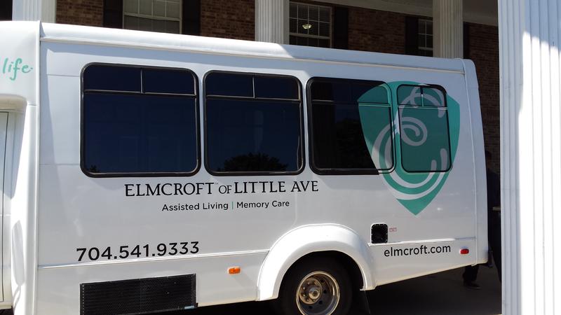

We're not doing it as after they sent this to me, I simply asked, they half followed your request and half didn't do it...... which is it ??
Got a response back,
We have done more then 20 of these and so we understand the issues and so does our client. All we want to do is to complete the van per the artwork I sent you for this location. You would be the most expensive thus far and possibly would go up..
We actually quoted what they said they are willing to pay, so I don't know how we suddenly became the most expensive........ :doh:
Dodged the bullet on this one...................
