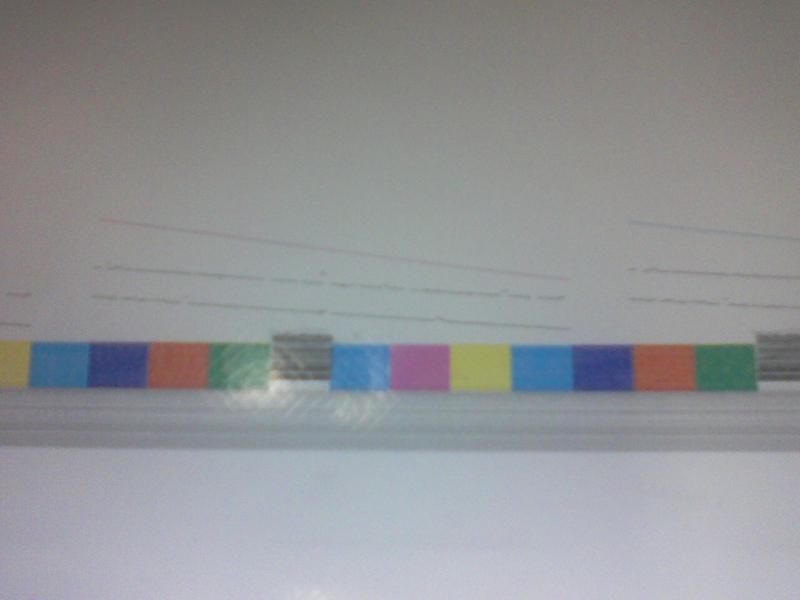

Suggestions? Black didnt do that before, it was good and clean, now it gets steaky, like it bleeds....What do you guys think? Im just happy I finally got this booger to print something!

Loosen the screw that holds the black head, reseat the head make sure it is parallel to the color head, then do the electronic adjustment.

what about the steaks? I'll take a pic of a test print I did after I feed my Dad his lunch...

I had the problem with the streaks on my yellow in nozzle check and it was resolved by replacing the damper, still don't know why.
