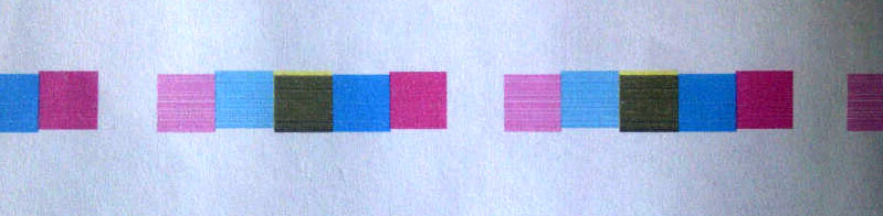

I'm in the process of fixing up an old RJ6000 that has been converted to ecosolvent. I've got it to the point where I'm doing some preliminary test prints....
When I do a nozzle check I'm getting what looks like: M, C, K(overtop Y), LC, LM.
When I do a test print... all that is printing is M and Y no C or K.
have no idea what to do next to try and fix.
Haven't even got to the point of hooking up a RIP, I'm just doing test prints right off the printer.
any suggestions?
PURVEYOR
here's the nozzle check. I know its not aligned, I'm not there yet. Just trying to get it printing properly.
where the black is, there is yellow firing underneath. so it would seem all inks are firing.... but this doesn't look right to me.

randya
Looks like you need to align the K head electronically.
Should be a few posts around here to describe that.

soypaul
Cmykyk unselect
You have in your mutoh menu, the option to use cmykyk channels, change that to no.
Problem solved
