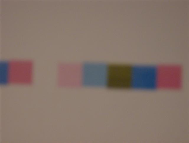

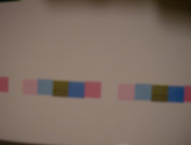

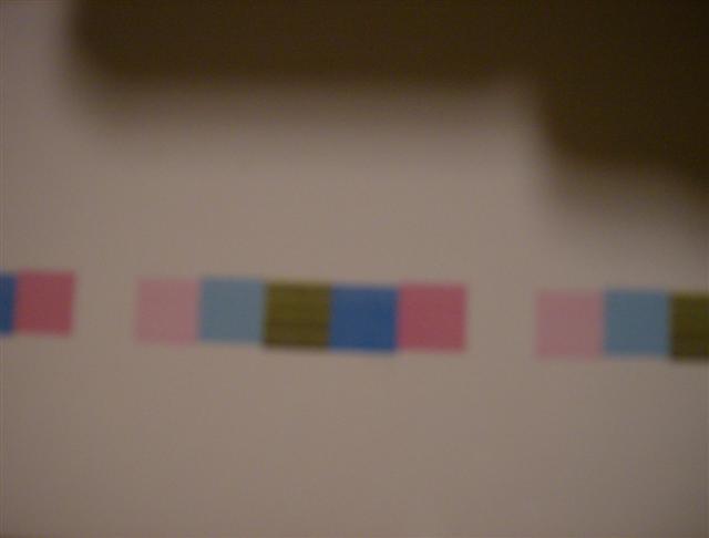

Ok I add new heads then found that one head was bad and all I got was a long line of black over the other colors when I did a nozzle check... I add the old head back in and printed fine...so with that said I did a nozzle check and printed it out and this is what I got the color blocks are all off not in straight line and it looks like the black printed over the yellow any ideas do I need to do an alignment which I know nothing about to get it all correct
I have a Falcon Outdoor
Sorry about the bad pixs but that seemed to be the best I could get

Compilla
Go to Menu>Function
Find and make sure these settings matches yours:
KCMY KMY ---> NO
CMY Black ---> YES
KYCMYK ----> NO
Good Luck!
PS.- Your mechanical alignment is OFF
