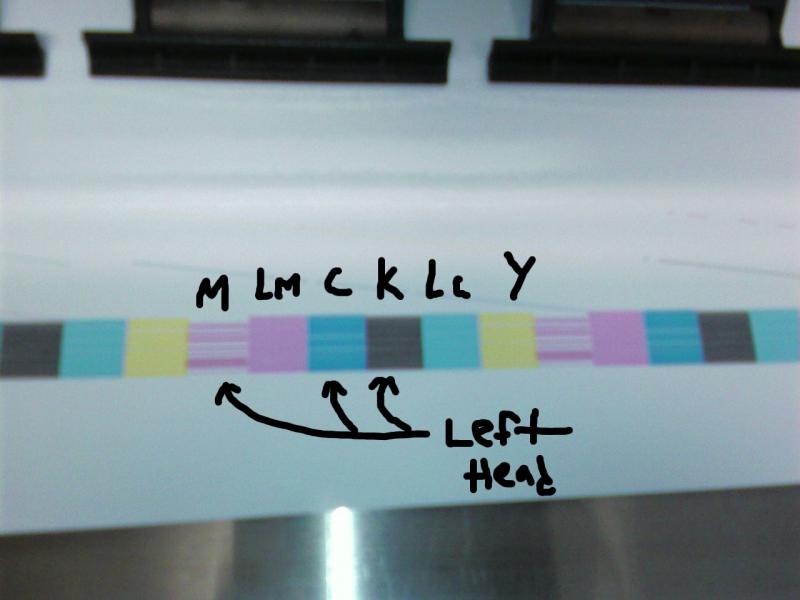

I just replaced my left print head this week due to black being clogged on the old one over time and soaks/pushing cleaning solution through that nozzle couldn't clear it up.
Now I can't imagine my new problem being from the new print head, because it's new... and the capping station, dampers, and o-rings are pretty new too. So maybe you all can come up with an idea.
Pulling ink from the waste lines does clear up the problem a little bit but there are still a lot of lines through magenta and it looks sketchy either way.

Check to make sure the pump is working and actually pulling ink through.
Pump/assembly & motor that carries the heads back and forth is around 6 months old and I can see some ink moving through the waste ink lines when it runs a cleaning cycle so I assume that it's working decently.
