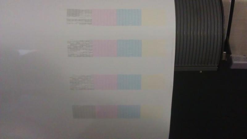

Hey guys i had problem with my black print nozzle test, and i decided to change the capping station and the pumps. Before there was an air leak between the cap station and the print heads but now there is no air leak, but still am losing some of the nozzles of the black print head. So what's next. Should i replace the dampers first and see if the problem goes away or replace the dampers and the print head manifold. This is 4xCMYK mimaki jv3 spii. You can see from the picture i attached that it starts fine but then it loses some nozzles.

When i do head soak it clears up, also when i pull ink from the bottom of the cap station also it clears up but when i start printing after few feet of printing, it loses some of the nozzles, sometimes the whole black is gone.
