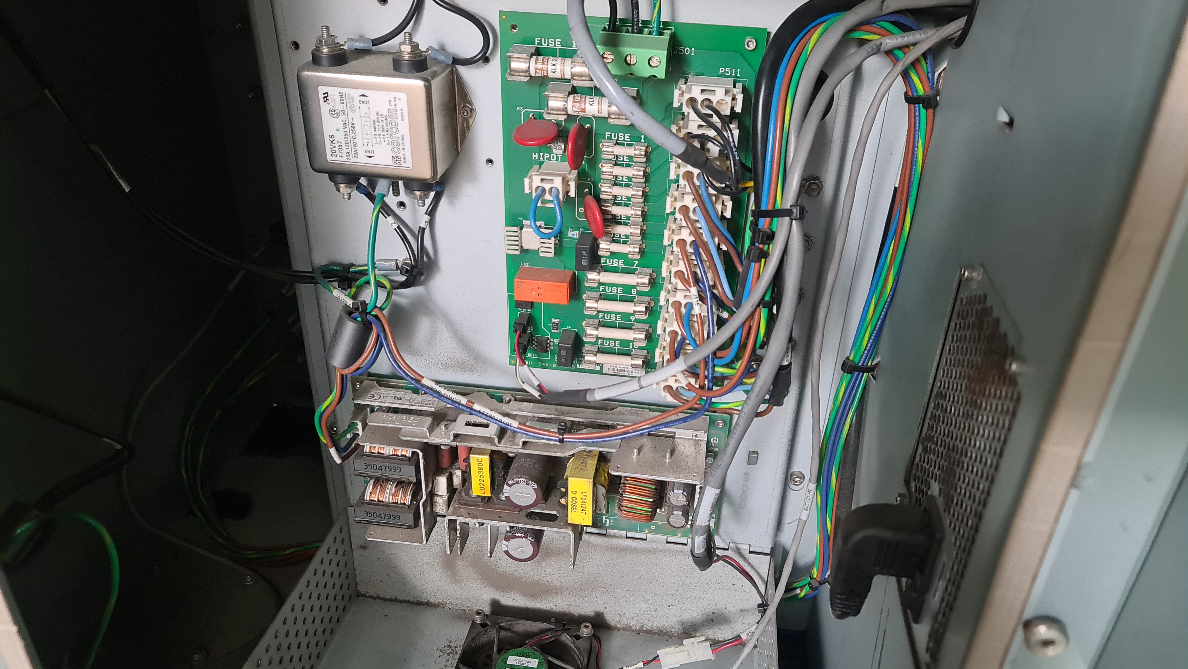

I managed to open the power units's covers.
1. there is only 1 of main power cable going into the big power unit. the small fan in the unit spins. I test all the small and two big fuses are fine.

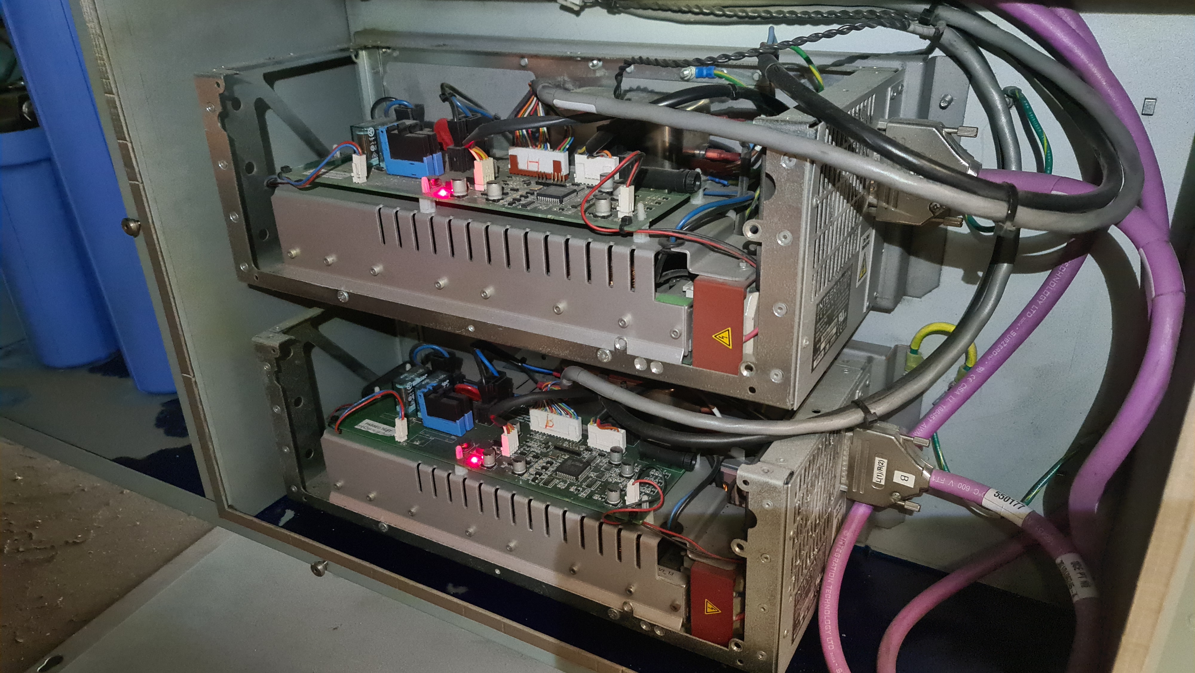

2. the two units board under the flat bed lights are red on, and noise comes from the two sides of the carriage.

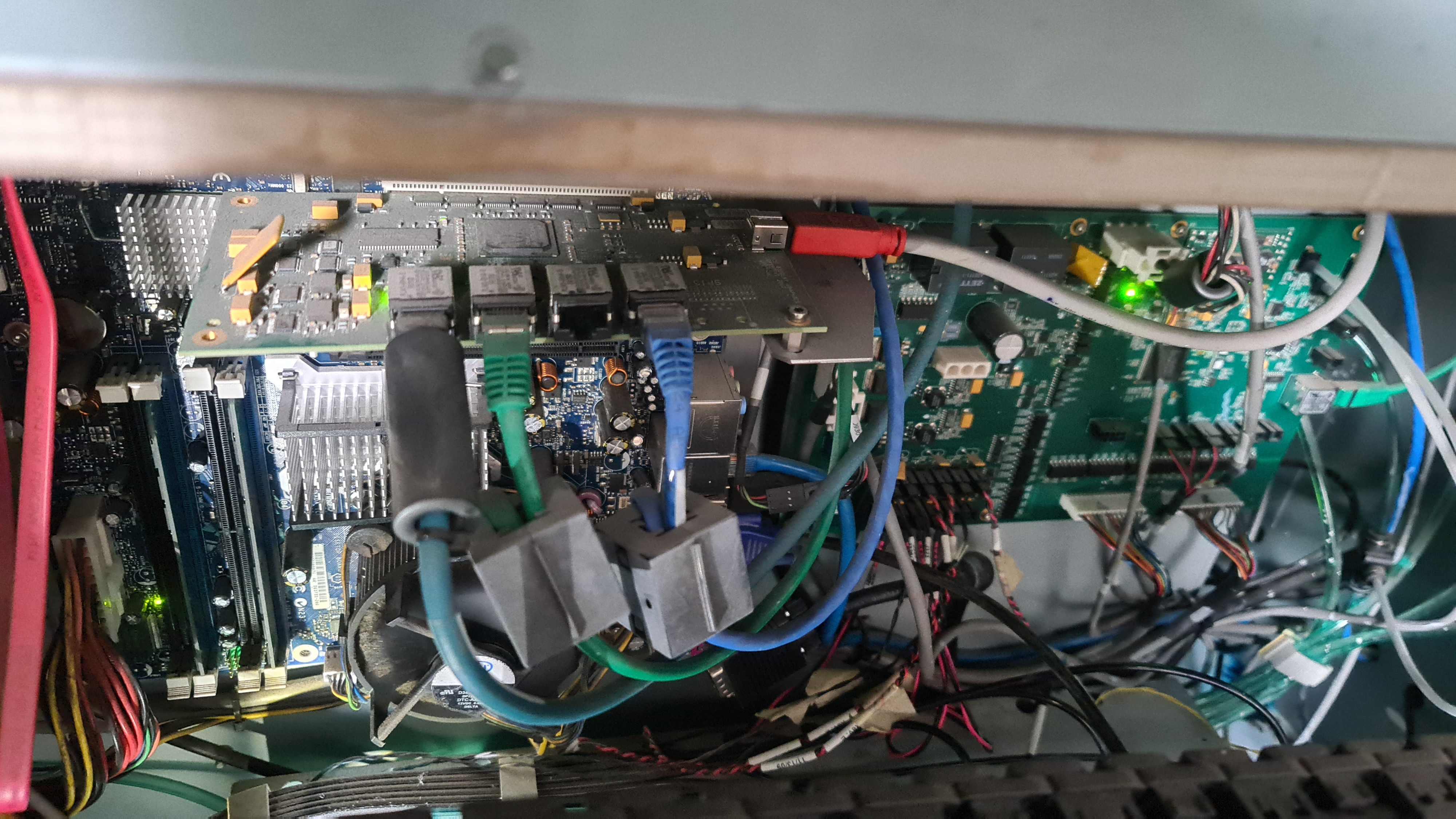

3. pc unit lights on, fan spins. no beeping sound. I connect a working monitor directly to the pc board, still no display.

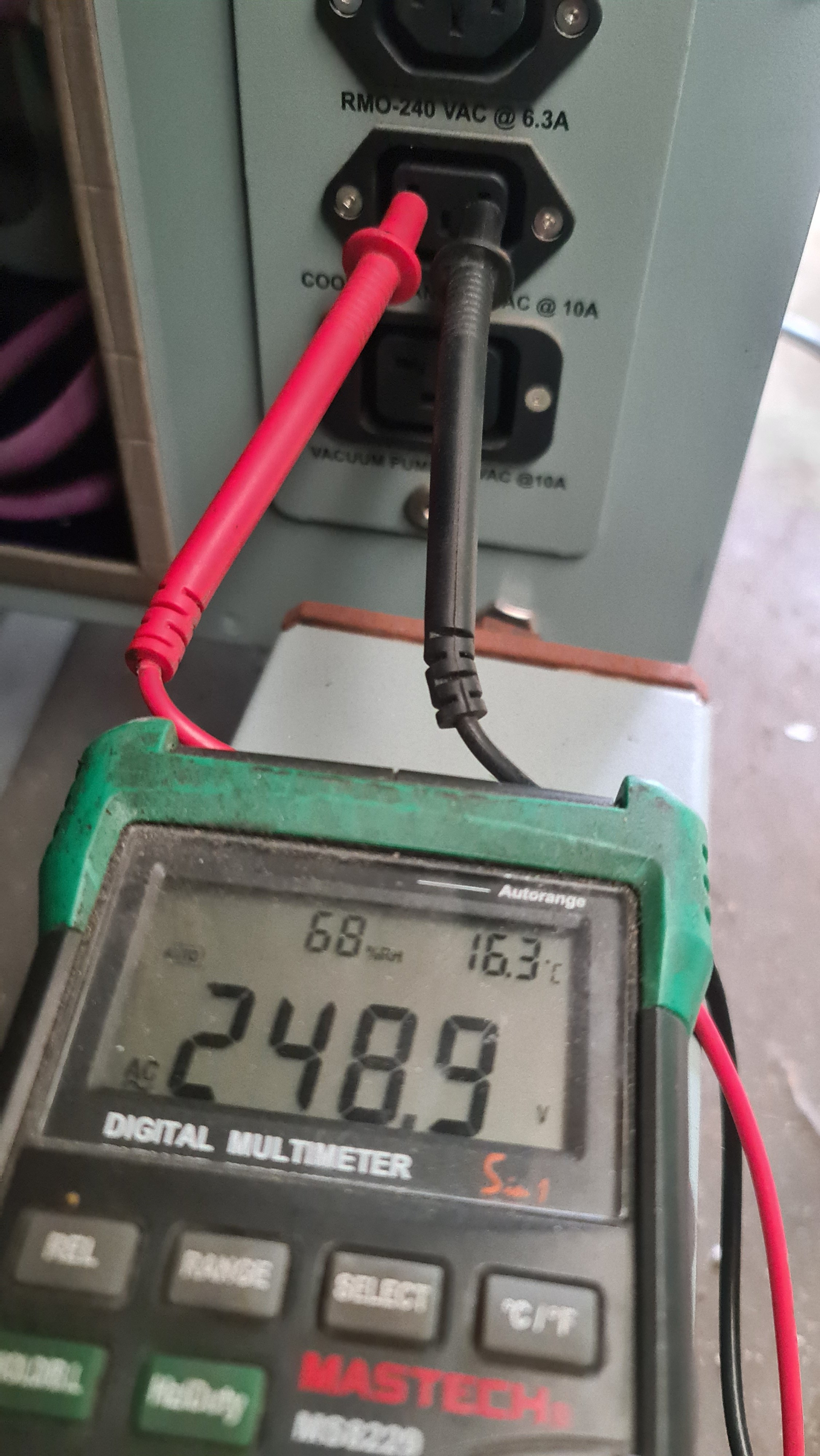

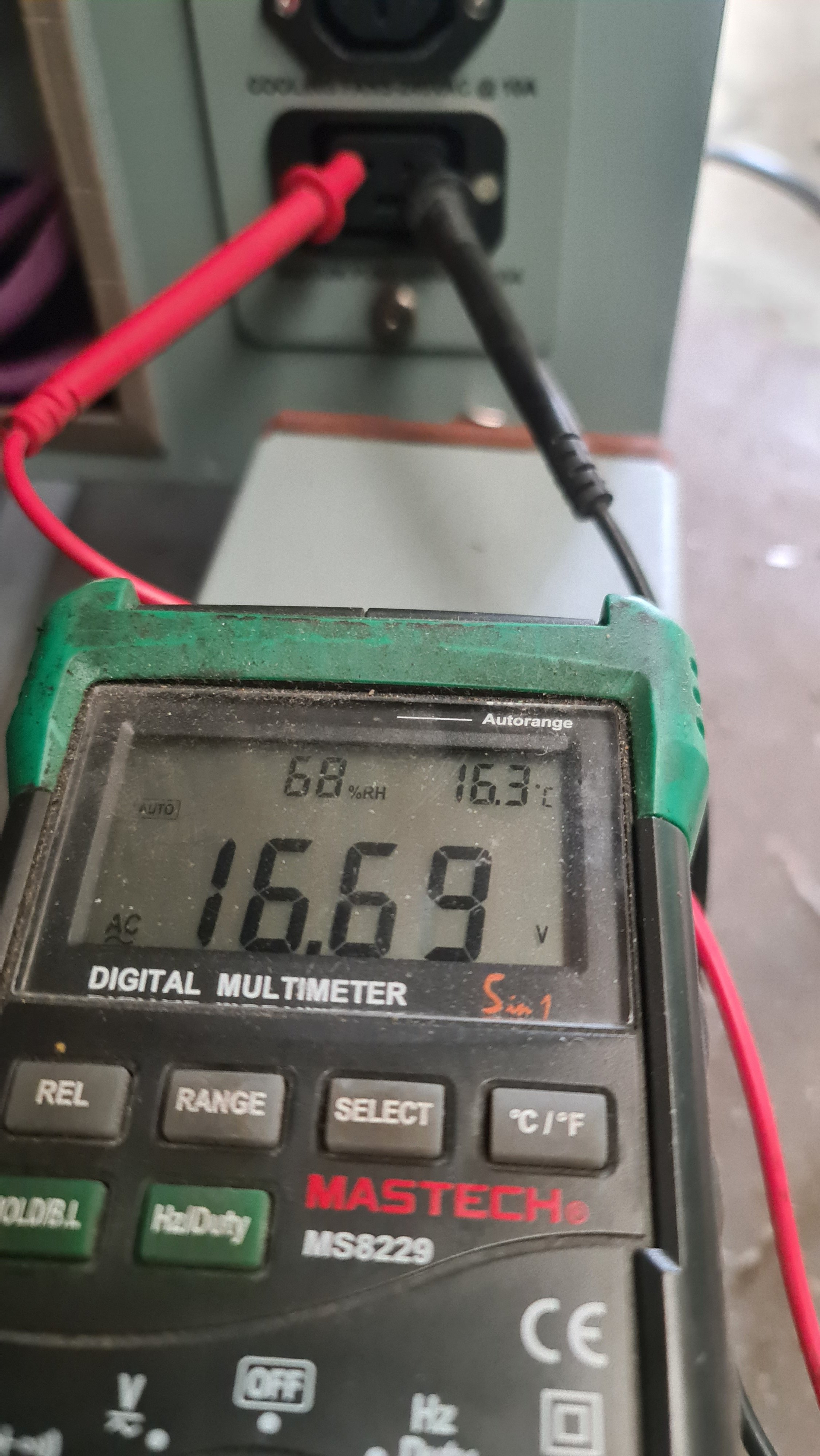

4. the vacuum power supply only is 16.69V, not 240v. the other two supplies are about 240v.

looking at your photos, I can see that the motherboard has power, also is very dirty (cpu fan / heatsink clogged) I would try reseating the memory with the power disconnected and see if that helps. As a matter of maintenance I would also clean up the dirt as well. Hopefully the motherboard hasn't failed.
Steven.Cao
Air blow everything for thr oc parts. I notice the cpu's fan spins 2-3 seconds then stops, then spins again to normal when the power is on. It did the same with memory removed. I can hear the hard drive spinning. But still no display when connecting a working monitor.
