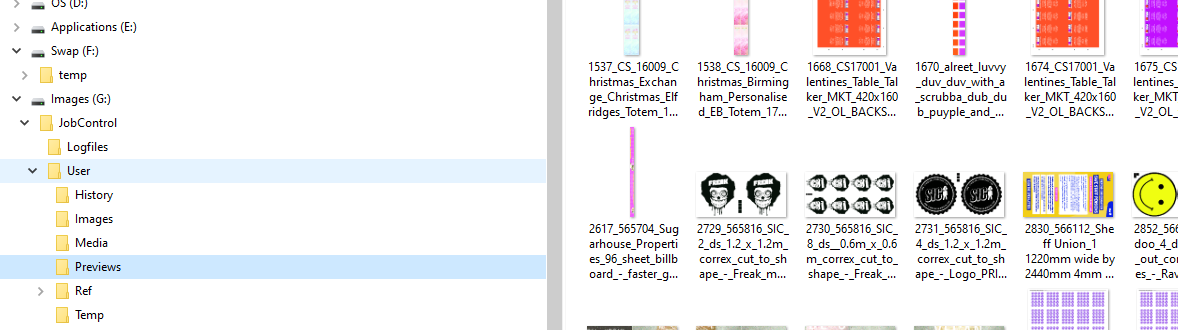

I connect the hard hard to another pc,
find the files, even the previous job preview.
next step, try to find a similar mother board, see what will happen.

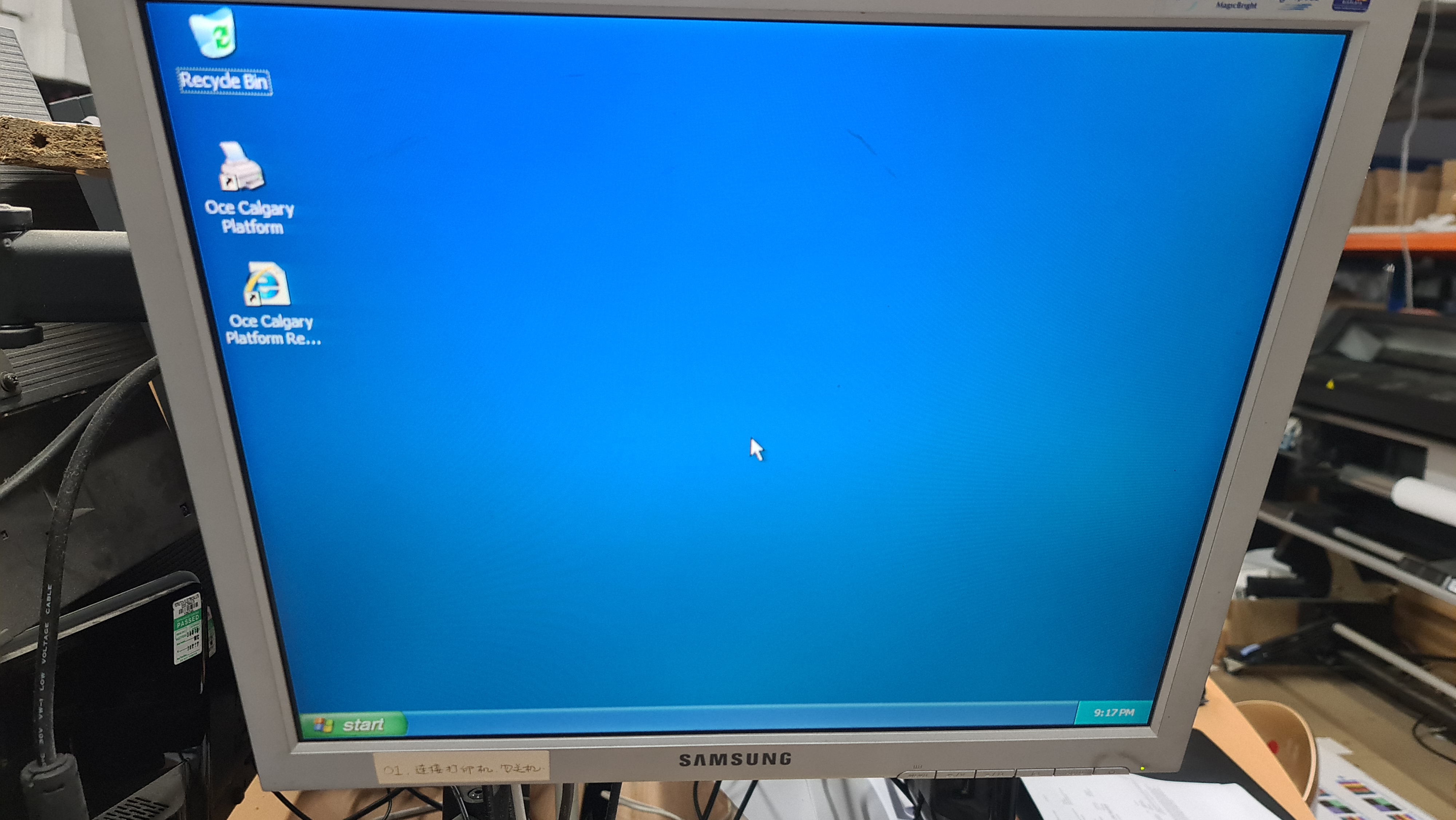

I just installed the printer's hard drive on my old WinXP pc.
the pc can be powered on and log in WinXP system.
but the mouse can do nothing until the software opens. then it pops out the reminder information.
i can not click anything else except the software, is it normal?
if so, can I safely install this motherboard and hard drive back to the printer now?

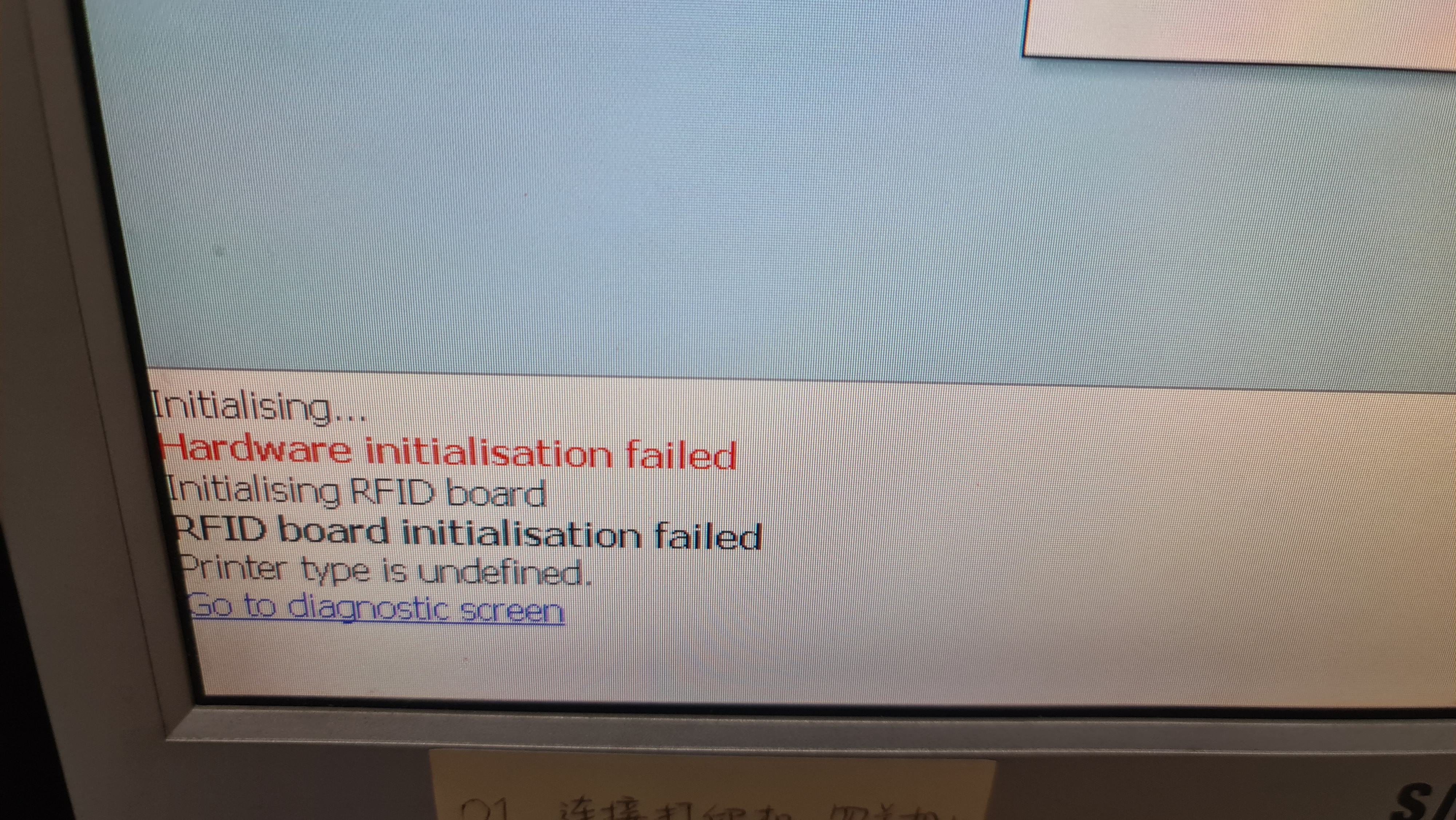

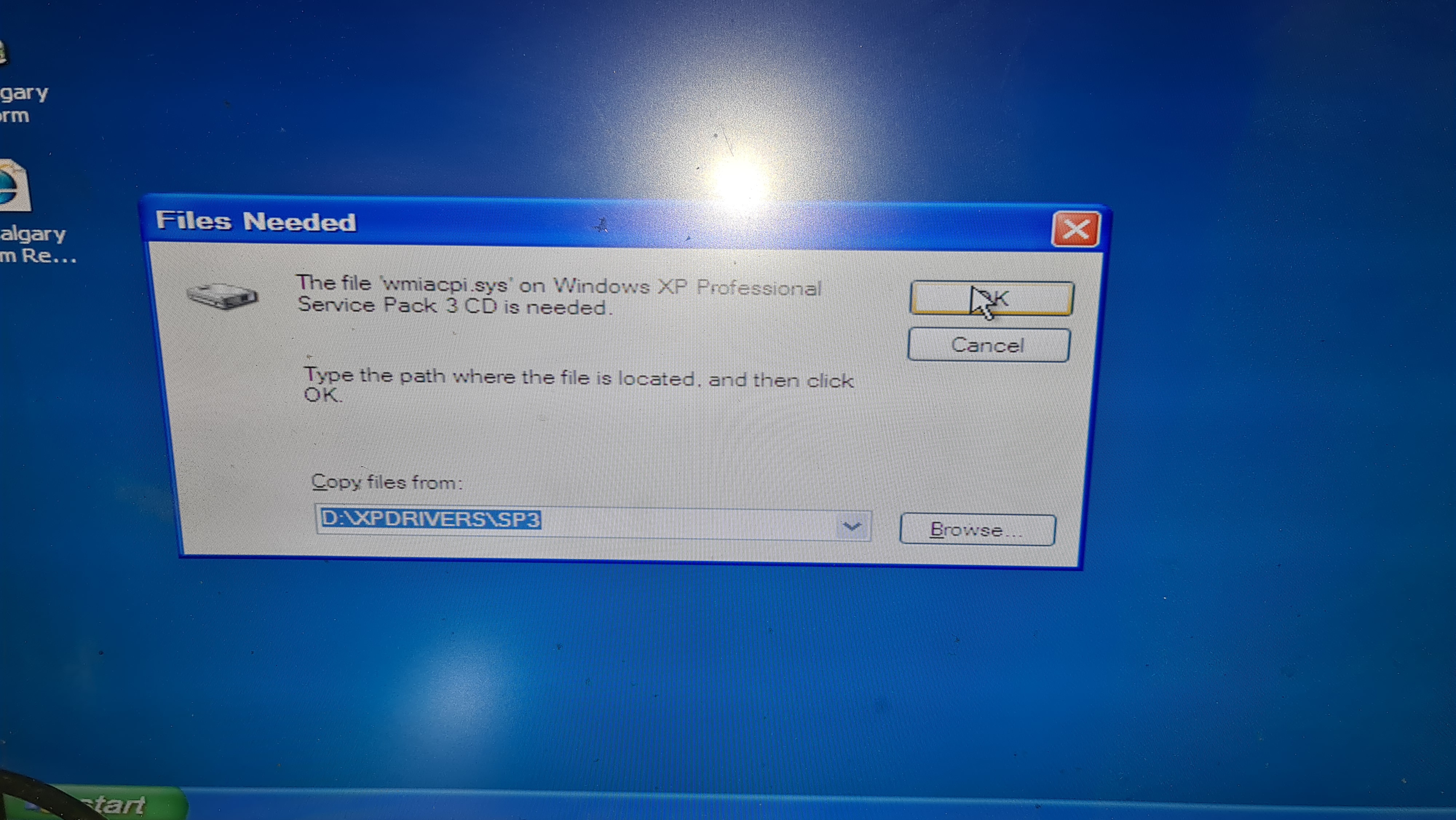

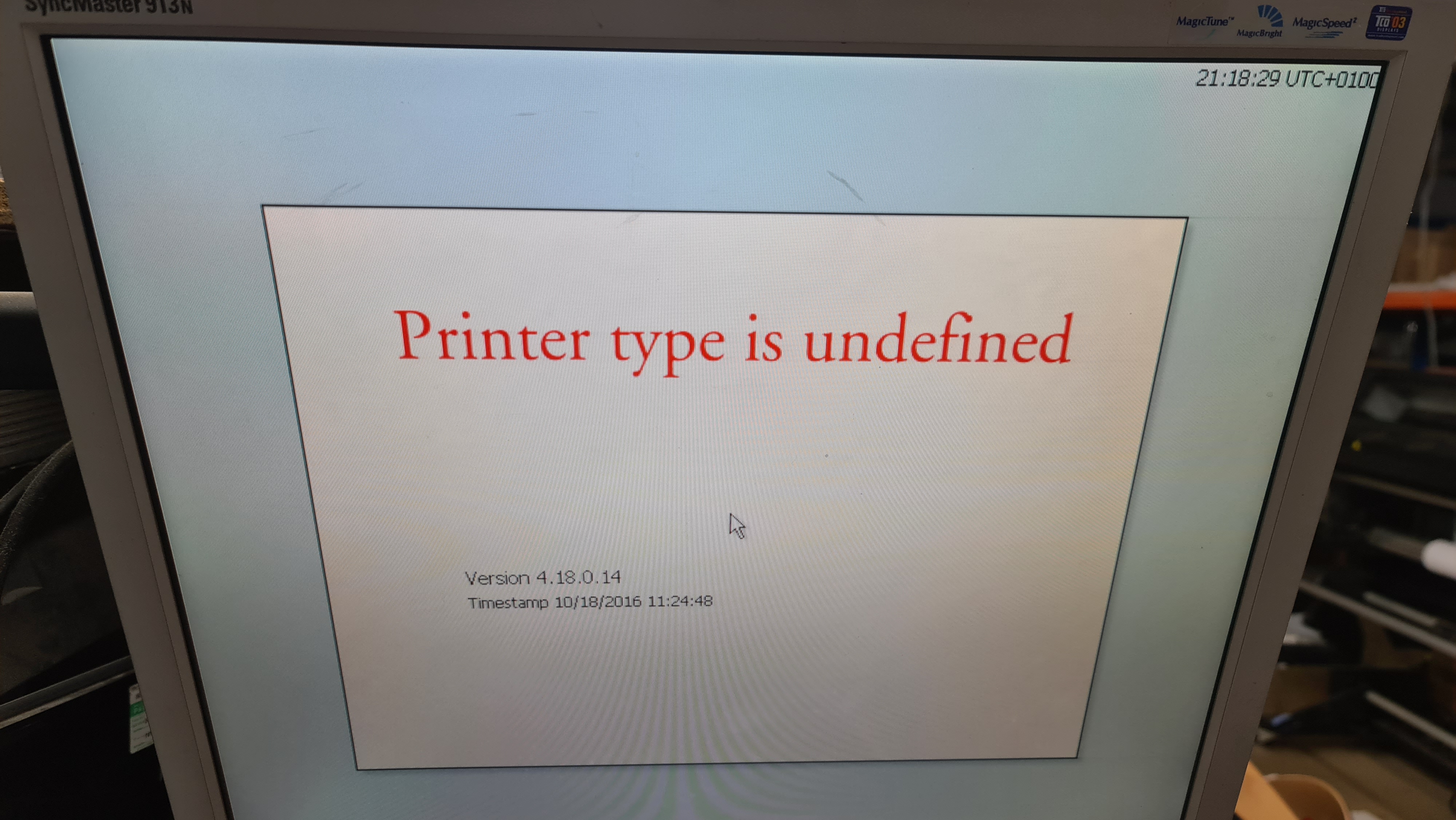

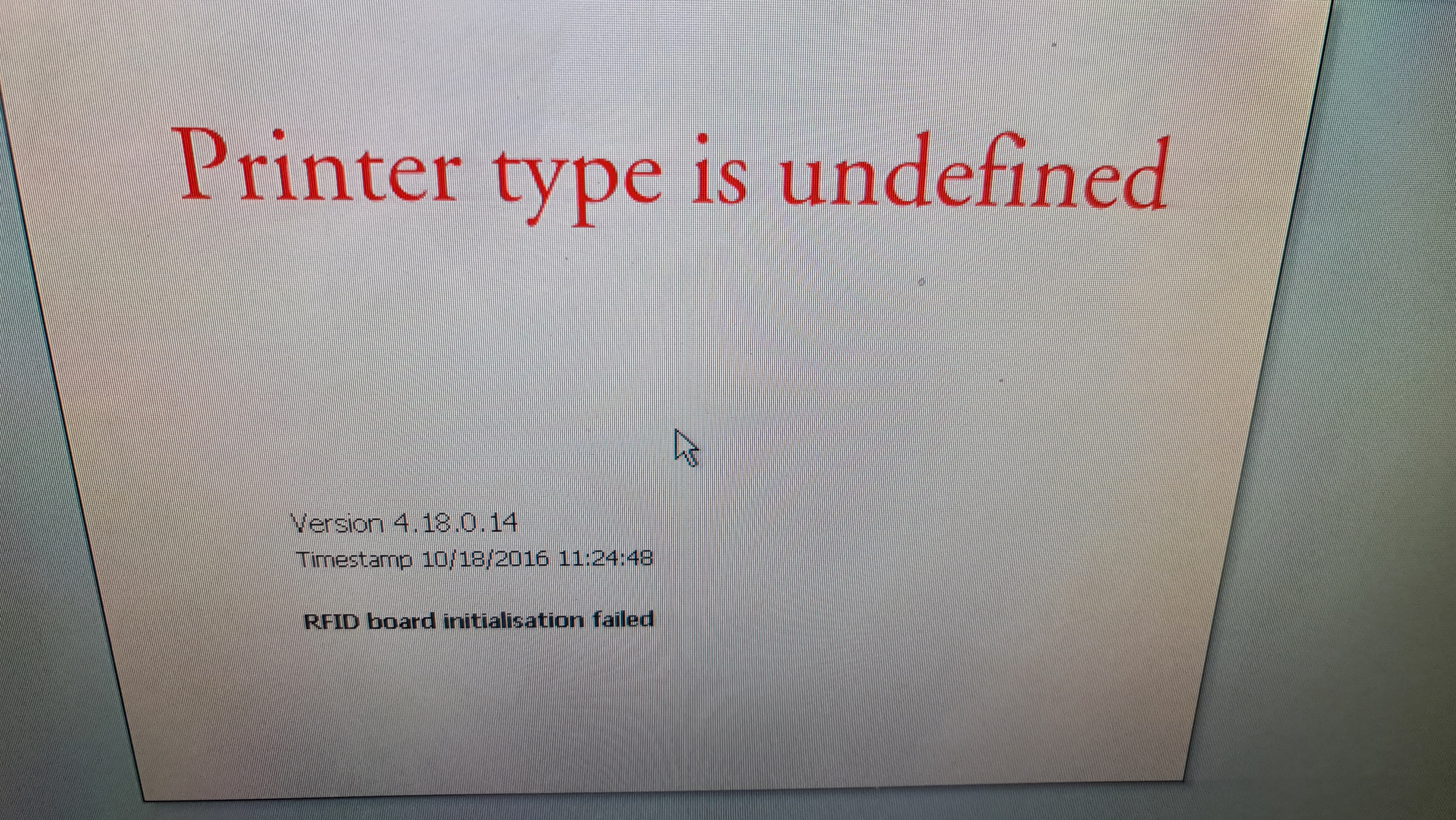

Hi guys,

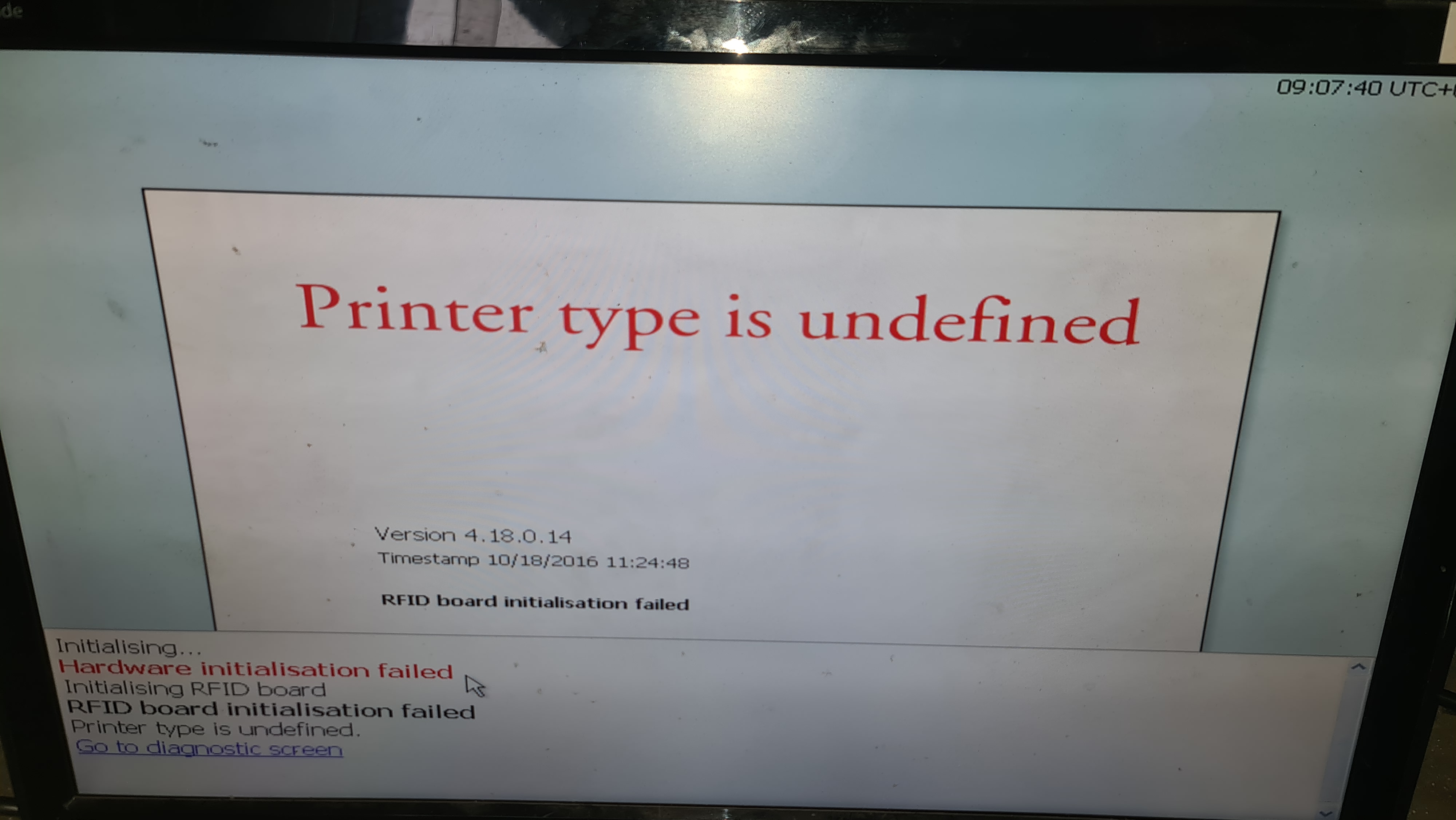

I installed a motherboard from my old xp pc on the printer.
after it powered on, it reminded me that the printer is undefined. RFID board initialization failed.
then I click the Diagnostic screen, update a Calgary Platform 4.18.0.14 Setup, it passed the installation, 350GT image showed on the screen.
then it reminded me to raise and then lower the carriage guard.
I did that and click the Confirm or Continue button, then the error message showed up.
I tried to click the reset error button, but the printer stuck there, I can not go any further.
After I restart the printer, It failed at the RFID board initialization step, then a error message 'wmiacpi.sys' on windows xp service pack 3 is needed.
I guess there is some driver missing, where can i download it?
Thanks.

did you look at the printer before buying it?
Was it running etc?
Because if the RFID board is not working, you're going to have a hard time finding a new one or even a used one.
And with WinXP. it doesn't like hardware changes, especially different motherboards, CPUs, ram etc. Which may explain why the mouse isn't responsive.
Mouse and keyboard work fine on my arizona when plugged in.
classicgameswi
you likely need to install drivers for the different motherboard, this is possibly why you have gotten the RFID board error. Use a PS/2 keyboard plugged directly into the motherboard and go into device manager, you likely have some drivers missing. If you can get into device manager, take a picture of it and post it here
If you are not a computer guy, you may be better off buying the correct motherboard off ebay so that you dont need to load drivers.
Steven.Cao
thanks, I will try to find the missing drivers.

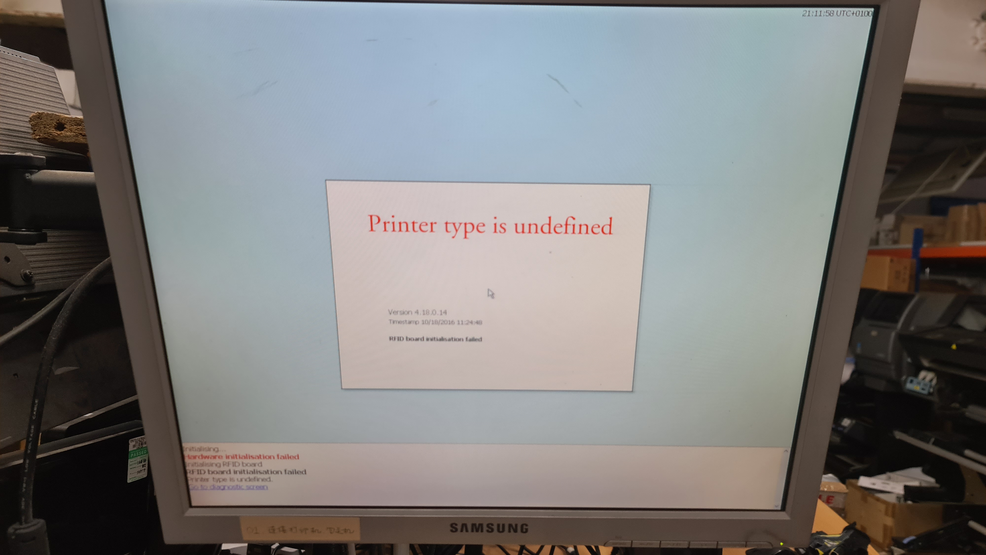

The network driver is installed.
The RFID board was still not working properly, the software only got once working, then stuck after the cartridge lifted. It kept reminding reset errors.
When I restarted the printer, the RFID board installation failed again like before.
Is it because the oce driver/software doesn't work on the new motherboard?

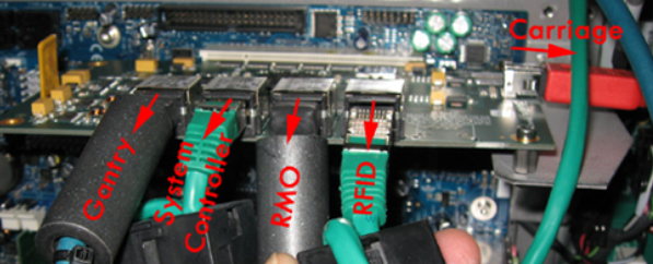

Did you go into device manager and verify if there are any unknown devices? take a picture of what you have in device manager and post it.
Also, make sure the cable for the rfid board is plugged into the correct port shown in the attached photo on the data relay card. While these look like ethernet cables, it is a proprietary connection and the port assignment matters
Steven.Cao
I bought same model board on ebay, installed and power on.
The installation of RFID board passed. Thanks for the helps.
