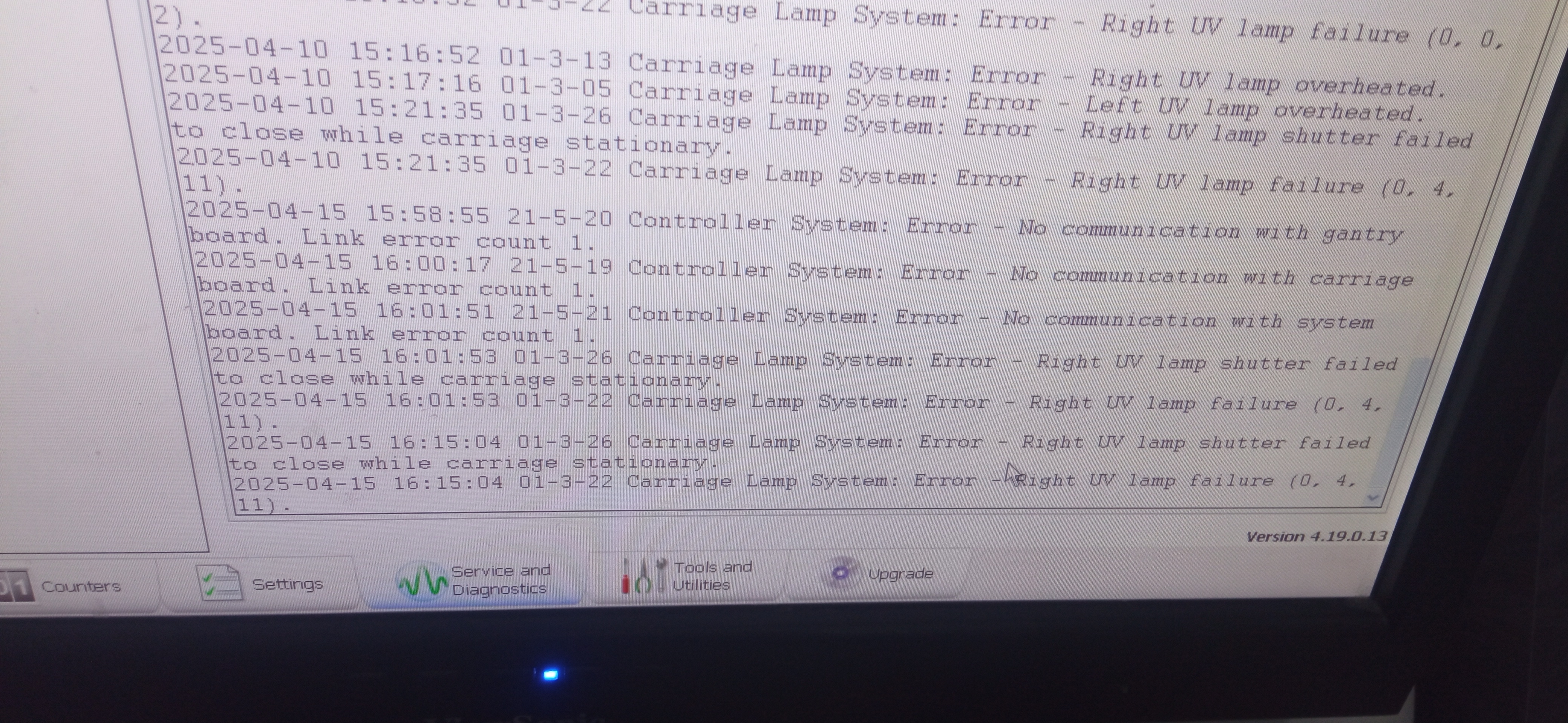

someone have ide for oce gt 365 ?... its alwas right uv lamp,, even im try swap the left lamp..error still right uv lamp, have change relay, swap the board uv power under table...still same ...what make me crazy is error still in right uv in every errror IMG_20250415_161741.jpg
check in service diagnostic shutter and warmp up lamp is ok
someone have ide for oce gt 365 ?... its alwas right uv lamp,, even im try swap the left lamp..error still right uv lamp, have change relay, swap the board uv power under table...still same ...what make me crazy is error still in right uv in every errror View attachment 176906
because the problem is not inthe lamp. Check the fans of lamp power supply(balast's).
If ypu are lucky man the balast will work. Just right ballast fan doesnt work.
Cross the ballst cables and check fans for now.
If this is GT or GL the ballast's are under table in right leg.
If this is 350, 360 XT the two ballasts with two control boards are near to power cables 220V under first cover. The ballasts are other side of the big cables with same blue connectors. Cross cables at ballasts also and write what happens.
So ...
If you change the possition of the lamps and right lamp still doesnt work this mean that the problem is not in it.
Just find the ballasts for now.
saaeru
So ...
ok sir... will try it...
Find Fireware cable and just baypass this in IGUS chain. It is easy. And check the ballasts fans.
If lamps starts and during the print stop, check ballast fans and the big cable with blue connectors.
