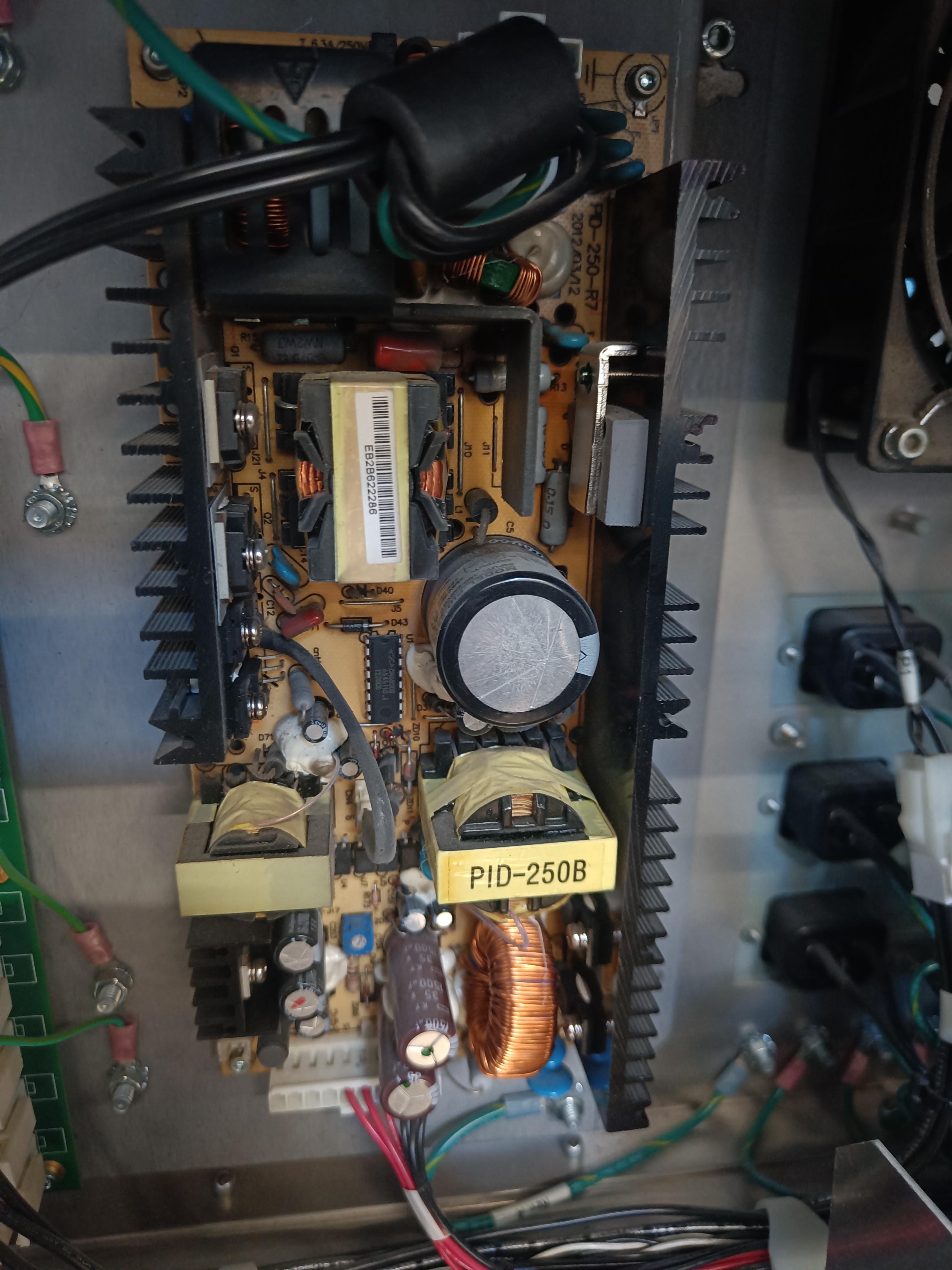

Eventually I was unable to get RFID to initialize at all. The problem was with this power supply failing to deliver the correct 24v output.
