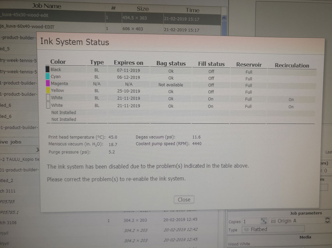

I'm having issues with what seems like RFID board. I keep getting "not available" for bag status, which happens with C, M, and K channels. Status will change to "not present" when I remove the inks, as normal. Canon already sent me replacement ink but that had no effect.
Anyone else have such an issue? I'd recently switched inks from Marabu, which used chips, to 257 and reader never had a problem with board detecting ink.
Try to swap RFID boards between sides, it's pretty easy (but do it when the machine is shut down). If the problem stays on the left side, it's related to the RFID board, cables or inks itself. If it moves to the right side, it's the RFID board.
