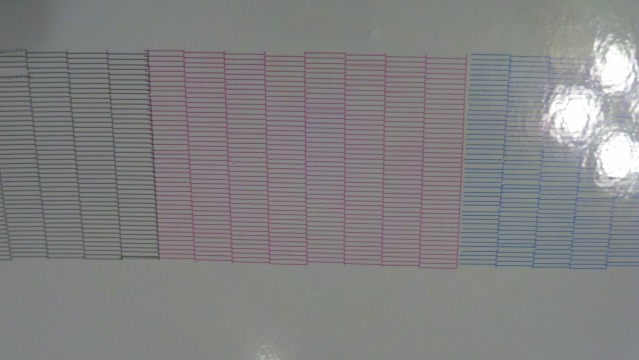

Banners Plus
Ok so am I turning the black screw in front of the head unit? after I losen the 2 allen screws. Here is a pic of what it looks like right now. It looks like it just printing slanted.

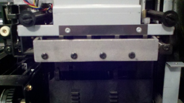

Im wodering if its these screws? the four black ones.
MikePro
i think those might be what they're for, actually. I've just tweaked them in the past thinking they kicked the front end over like I desired to rotate but must have ended up fixing it like i should have, somehow :)
give it a go. it makes sense, and it couldn't hurt.
