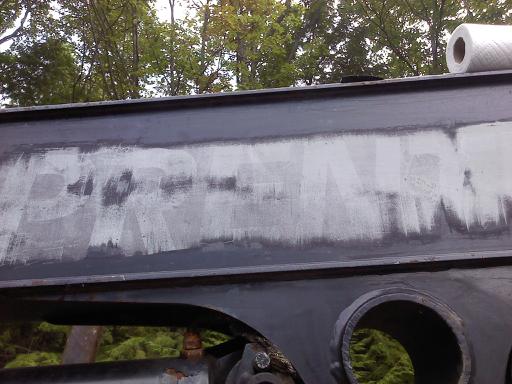

Thanks for all the tips! I ended up getting some Klean Strip brand Adhesive Remover and that took everything off including the paint :) I talked with the owner and he said do what ever you need to just respray with some semi-gloss and put the new decals on...
I took a pic after I removed most of the paint and the lettering is etched into the steel itself... Not sure what kind of vinyl the factory used but I imagine all the years of blazing sun and heat made it a permanent fixture :)

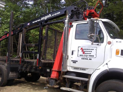

Finished Product
Well here she is all done... came out pretty good considering how much of a PITA it was to strip that upper boom.
