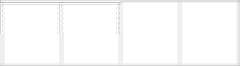

No, if you don't have welding capabilities, call one of your local welders who works with aluminum and get a simple 1"x1" square tube frame built with a couple of vertical supports in the middle evenly spaced over the length like this. Something that simple shouldn't be more than a couple hundred bucks tops. If your shape is not a perfect rectangle, you could make the frame smaller and glue in filler pieces along the edge to hide it, but at least you'll have that strength to be able to count on.

Hi Tim, As the blind man said to his deaf wife, "Ah, I see." Thank you. That will work methinks, with really good glue. And, that solves the problem of how to solidly anchor the sign to the posts, which are actually a couple of large natural stone pillars. I'll have some brackets manufactured which will bolt to the stone and extend out and bolt into the aluminum frame. That's very helpful.
