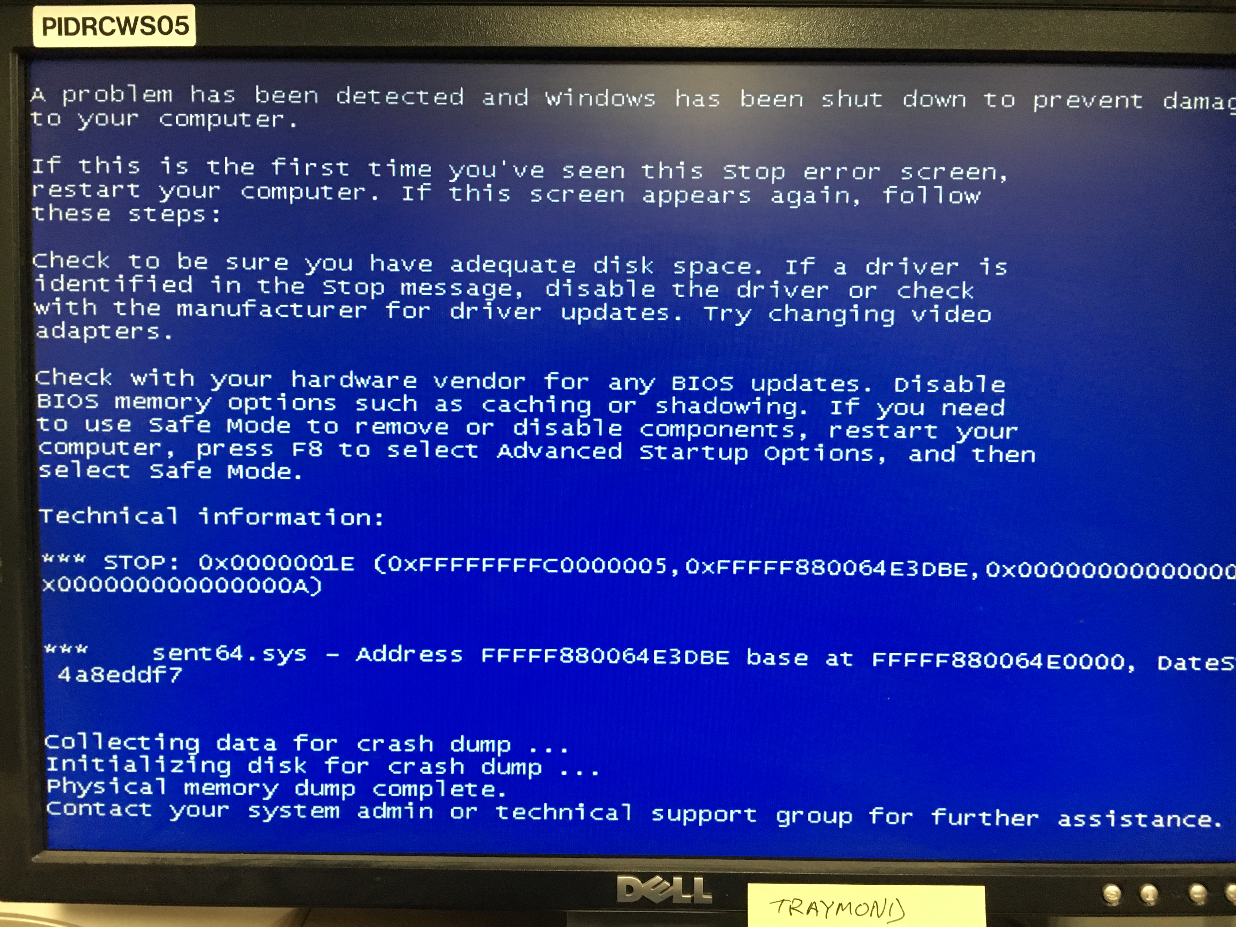

It is running Win 7 Pro and here is a photo of the screen.

If I'm not mistaken, that stop error is a memory leak. Could be a driver issue.
Restart in Safe Mode and see if it crashes, if it doesn't, it could be a software issue. If it BSODs in Safe Mode, got a hardware issue (whenever I got BSODs, it turned out to be ram sticks).
Check for virsus/malware if this computer sees the outside world and then check your drivers, make sure that they are up to date (and like it or not) make sure your Win 7 is up to date as well. Typically updated drivers go hand in hand with an updated OS.

Start Windows as regular, try to uninstall Safenet Hardware Key driver from Add/Remove programs. Reboot your PC and try to install Omega to see how it does.
