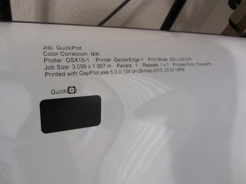

Am attempting to print my design it is a one color w/ script's ( text ) and for someone reason it just prints a solid block.
I wonder what am I doing wrong?

A couple of possibilities ...
Control +D to check that everything is on the same vinyl.
F2 to Select All and 0 (zero) to combine all shapes.
D-Kal
Thanks Fred
I got it to print but know its printing like a checked flag, design on the fonts and not solid black.
Fred Weiss
Merchant Member
F2 to Select All
9 to release Combine
F3 to unselect
Shift click to select individual objects
0 to combine
If you can't get it figured out, send the file to the email in my signature.
Fred Weiss
Merchant Member
For anyone interested, the primary problem with the file was duplicate white vectors hidden beneath the black vectors. This is a common issue with Illustrator files where a Pathfinder operation has been executed in creating it. Once they were removed the file combined correctly.
