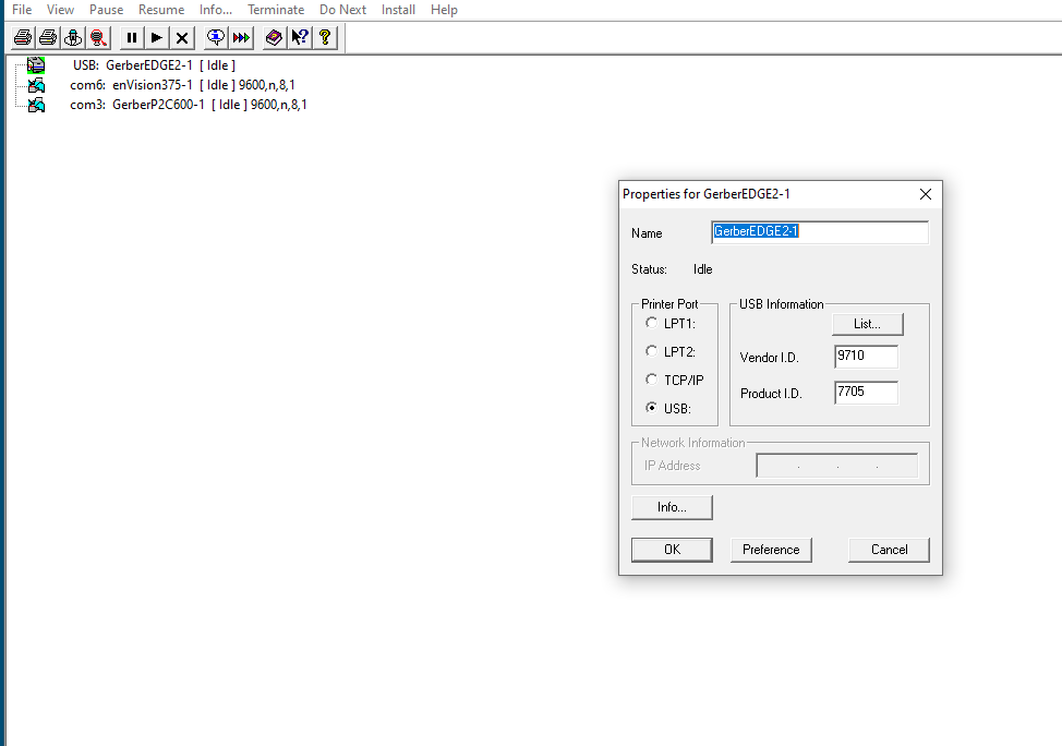

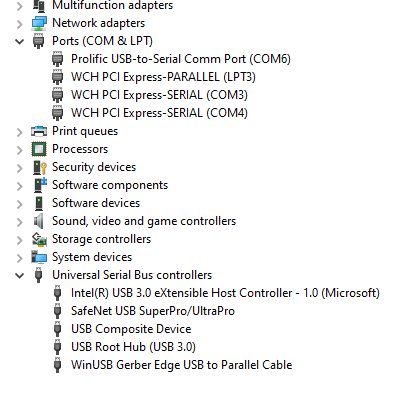

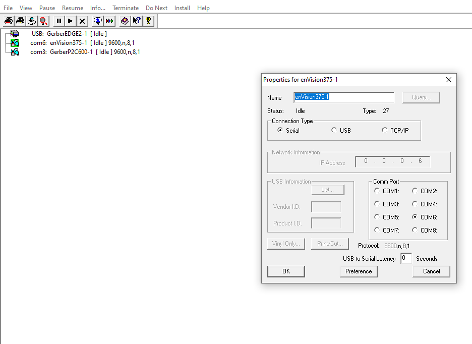

Here is my setup for reference - you need to look at the devices in GQ manager ( spooler) send a cut or prit job ( or open up GQ manager in the program file) and you can view your devices. ( I have my envision on COM 6 - which happens to be generic USB-serial adaptor.

jburns, what we needs to set is the com port settings
device manager>ports>comx>advanced. (ie: 8, 1, none odd, xon-xoff)
the usb to serial still needs to have the com port settings match the envision, the port created is virtual, but it is still a dumb device, just like the real com port. no plug & play device here. i have set these up for over 30 years (modems, shipping scales, scanners, hp laser printers <back in the 80's>)
