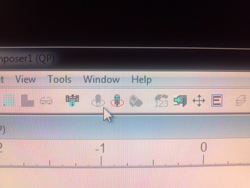

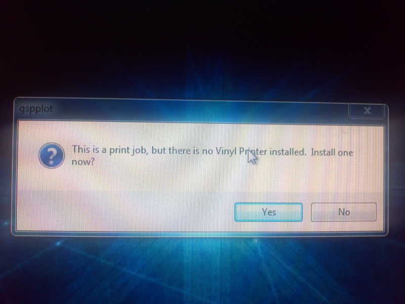

Hello everyone. I recently had to start a new user account for my icons to work properly with omega and corel. Its all good now but when i send something to cut. That i exported from corel x5 as eps. Its showing up as if it was a print job 2 pics are attached any advice.

Do you have any color fills or strokes assigned? When I export from Corel as an eps that I am going to cut in omega, I have only a stroke in Corel so I can see it. Once I am in Omega, I take the stroke off and it cuts just fine.

O yeaaa. I forgot. The vinyl only part. Thanks sir i totally forgot. You guys rock. And also i take strokes off and just manually put outlines in omega. And when copying and pasting to corel i leave off the outlines and put the strokes on in corel.
