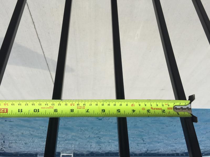

The plan was change and customer want the two panel back to back on fence . i don't want to screw in the fence bar.
I thinking to make sandwich but how to do this idea i don't know. You have idea.
This is the picture of fence bar.

Through bolts will look good on one side but not the other. I'd get some PVC at your local hardware store (used for window trim) cut 4 pieces 3" or 4" shorter than the width of your sign. Then install 2 on top and 2 on the bottom pinching the fence pickets with deck screws. I would add some silicone or power grab between the PVC and bars to make sure it doesn't slide down over time. Then you can screw your sign to the PVC with pan head stainless steel screws.
