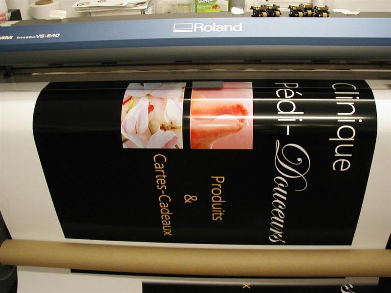

Wow! It's a new one for me. A customer sent me a file to print. Job has been made in full size, CMYK mode than saved in TIF. I open the file in VW, everything is fine so I start printing until I realize few second before it ends that 2 lines of text are missing in the bottom (???) I saw 'em on screen before hit the print button but nothing is printed in the bottom of the sign.
Pretty weird since it's now an image (TIF) and no longer vector paths from her design software (can't remember the name but I think it's Microsoft something... Publisher?)
Here's the screenshot and printed result...

It could be a layered TIF, and it's applying some kind of weird transparency to the text layer.
Publisher is an oooooold page layout program. Don't know what to say that wouldn't involve the client redoing the whole design in an actual piece of design software.

even more weird, if I select an area of the panel (Clip n' Tile), the black of the background prints deep black but I print the whole panel, it's greenish. Same file, same profile (in fact I printed the selection 1st and than release the clipping to get the whole image so I haven't changed anything in other settings... but I still double-check the process in case).
I'll cut the missings stuff on cast vinyl and lay it over the laminated panel.

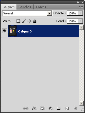

To my neighbor (GraphicWarning), it opens fine in Photoshop CS5 and everything is there, all on one layer...
When I say pretty weird, I mean WEIRD...

I haven't design the layout so the only thing I had is the "flattened" Publisher file saved in TIF. There was no layer and from all the preview thumbnails up to the real file re-opened in Photoshop, everything was included in the file. VersaWork is in fault here. It shows the the file is correct but doesn't print all the ingredients.
