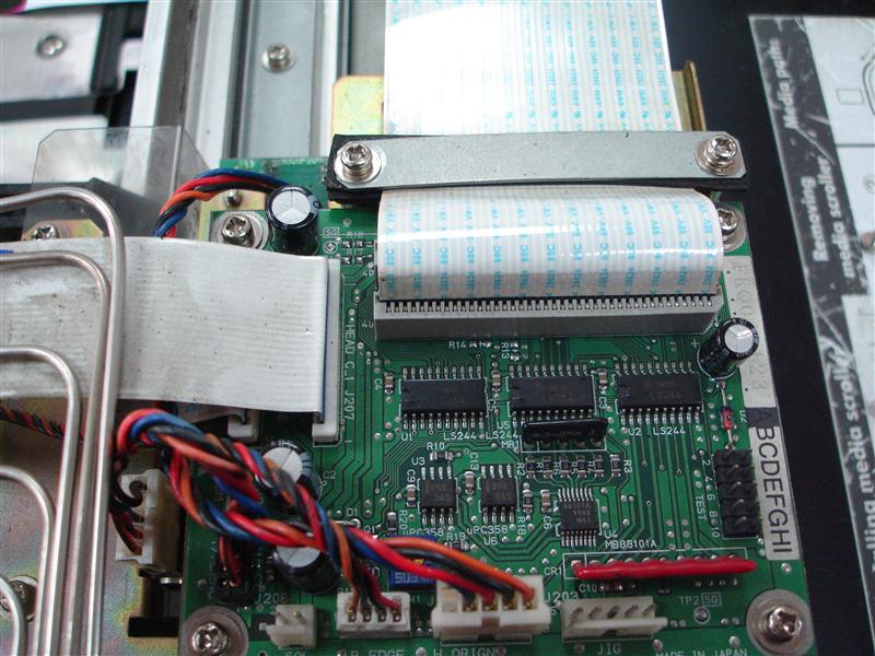

artbot
you probably have a loose data cable or bad head. maybe bad cable. being that there was in impact, it's should be the head.
attached is a photo of my printer with a loose black cable.

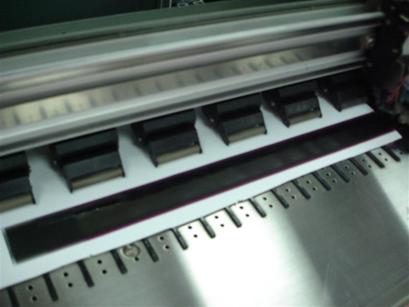

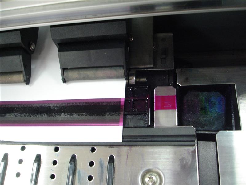

I've tried the connections - they all seem ok. Could the ribbon cable under the top cover be goosed somehow? If so, does anyone know where I can get them? I've attached a couple of photos which show the problem.
ps - i've removed the plug for the papercutter in photo 3 - it's not missing!!

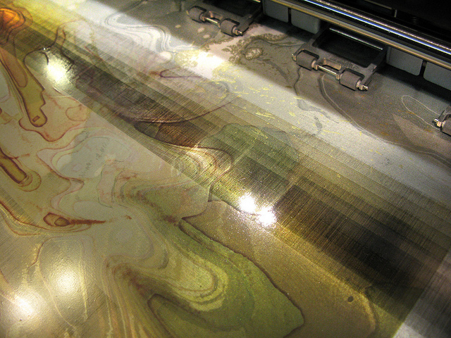

artbot
what the head color configuration on that printer? what type of heads? last time i saw two color stripe like that it was a fried board on an fj50.
IanK
Hey! I don't know about the configuration, but to the best of my knowledge, the printheads are Epson. Fried boards sound ominous :(
jhanson
You've got the old "DX3" heads -- 3 channel, 180 nozzles total. I'd say your head bit it. Only good news is that it's relatively easy to replace compared to newer printers.
