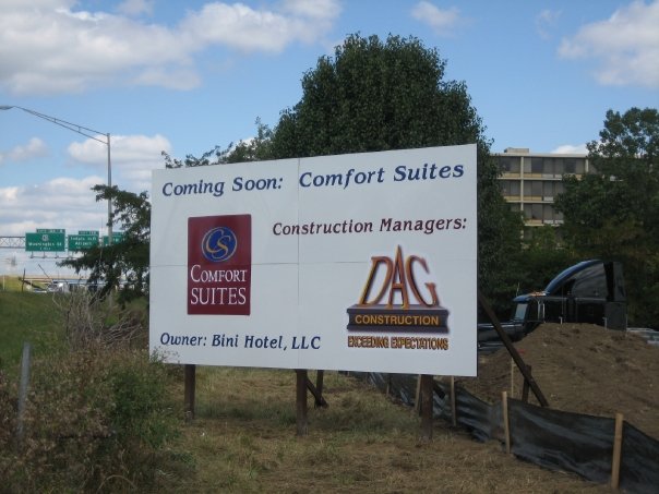

Anchor/mount treated 2x4's to the building face building a "frame" and supplementary mounting points for vertical panels of prints applied to polymetal.
Have the polymetal cut if necessary so that all the panels are the same size, and butt them up to each other.
Mount them to the 2x4's easily with self-tapping screws painted to match the area they are going in.
Should be pretty simple and will last many years.
Banner is not a good idea unless you can mount a stretcher frame to the building.
(kinda like the attached photo, I don't have any photos handy of exactly what I'm talking about)
