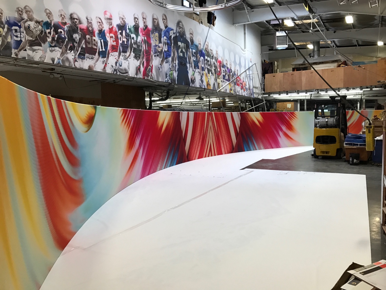

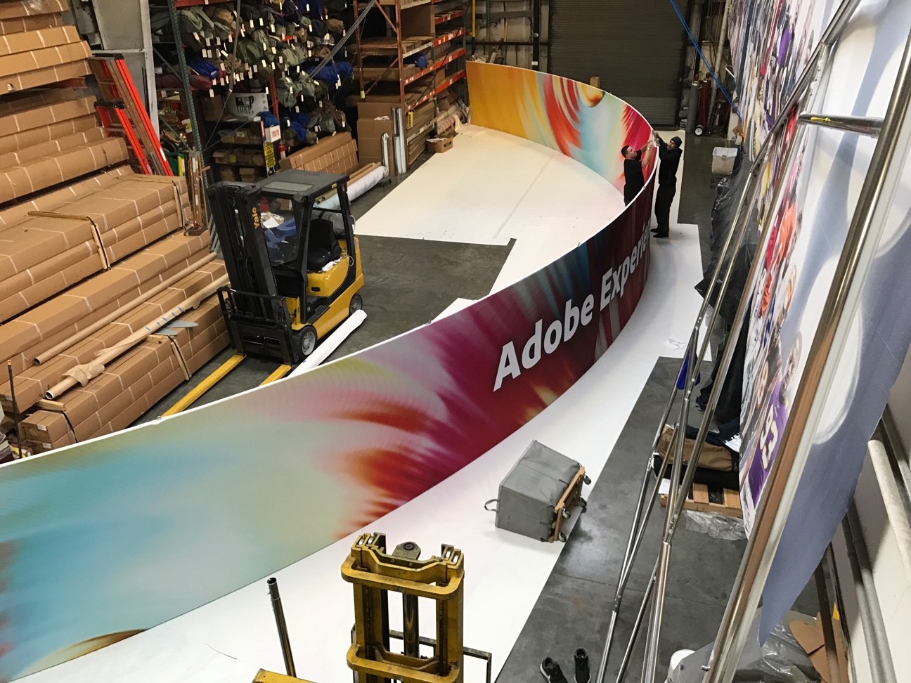

I just printed a 100' x 7' double sided dye sub cover for a well known graphic design software company...it had a line of text with a 60 foot drop shadow.
The effect clipped in Illustrator because it surpassed the (2 gig?) memory limit. It had to be recomposited in the background image with photoshop and re placed in illustrator with vector text over.
There are so so many things you can do in Adobe software, and so so many things that shouldn't be done. For us it's usually the construction of the art...not the rip.
When you are dealing with such large print files...resolution becomes a huge factor. For E3 last year I received a single .psb file for 30 foot tall x 400 plus feet of wall. The whole job ended up being 60-65 10' by 30' seamed fabric covers for 5 or 6 walls.
You can hit Adobe resolution ceilings very quickly going big like this.
Grand format printing is just different like this, than even wide format.
