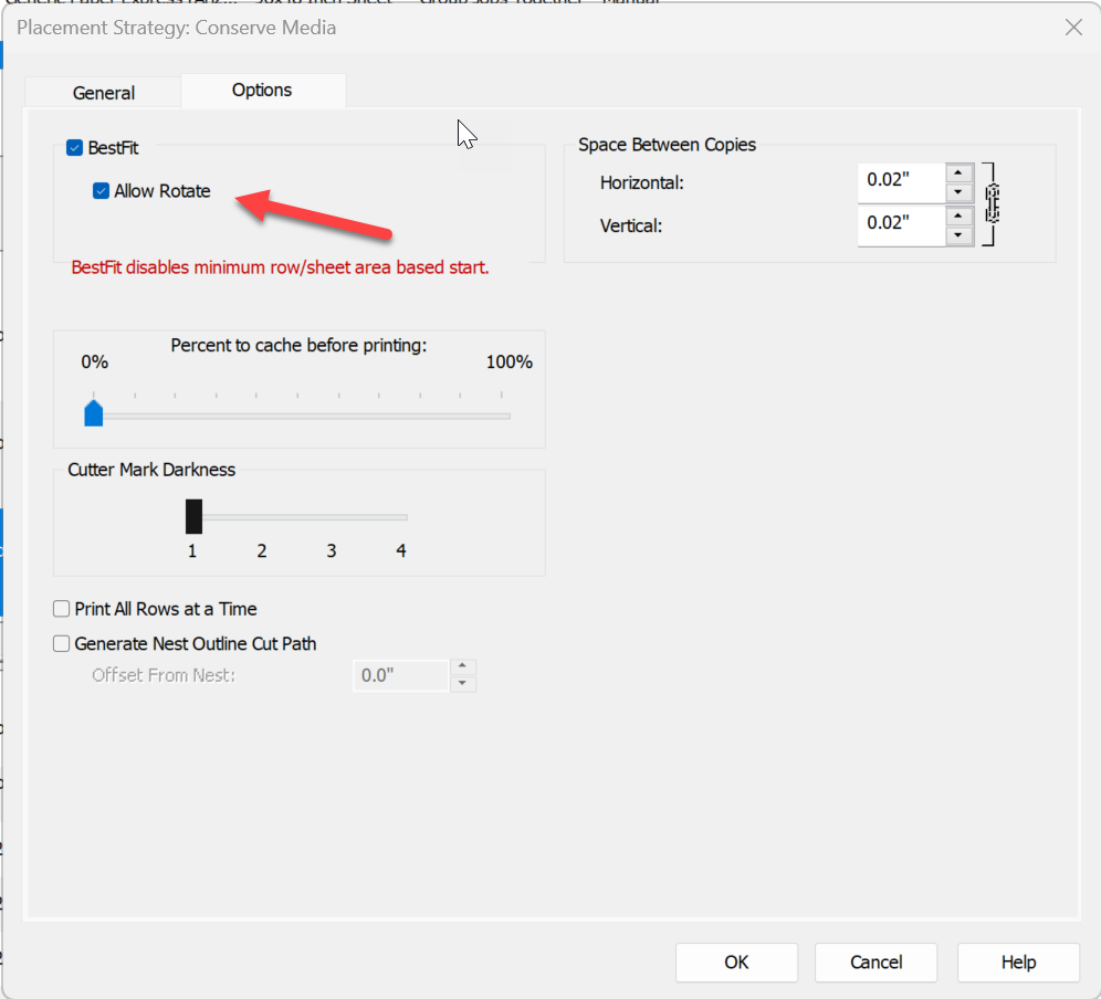

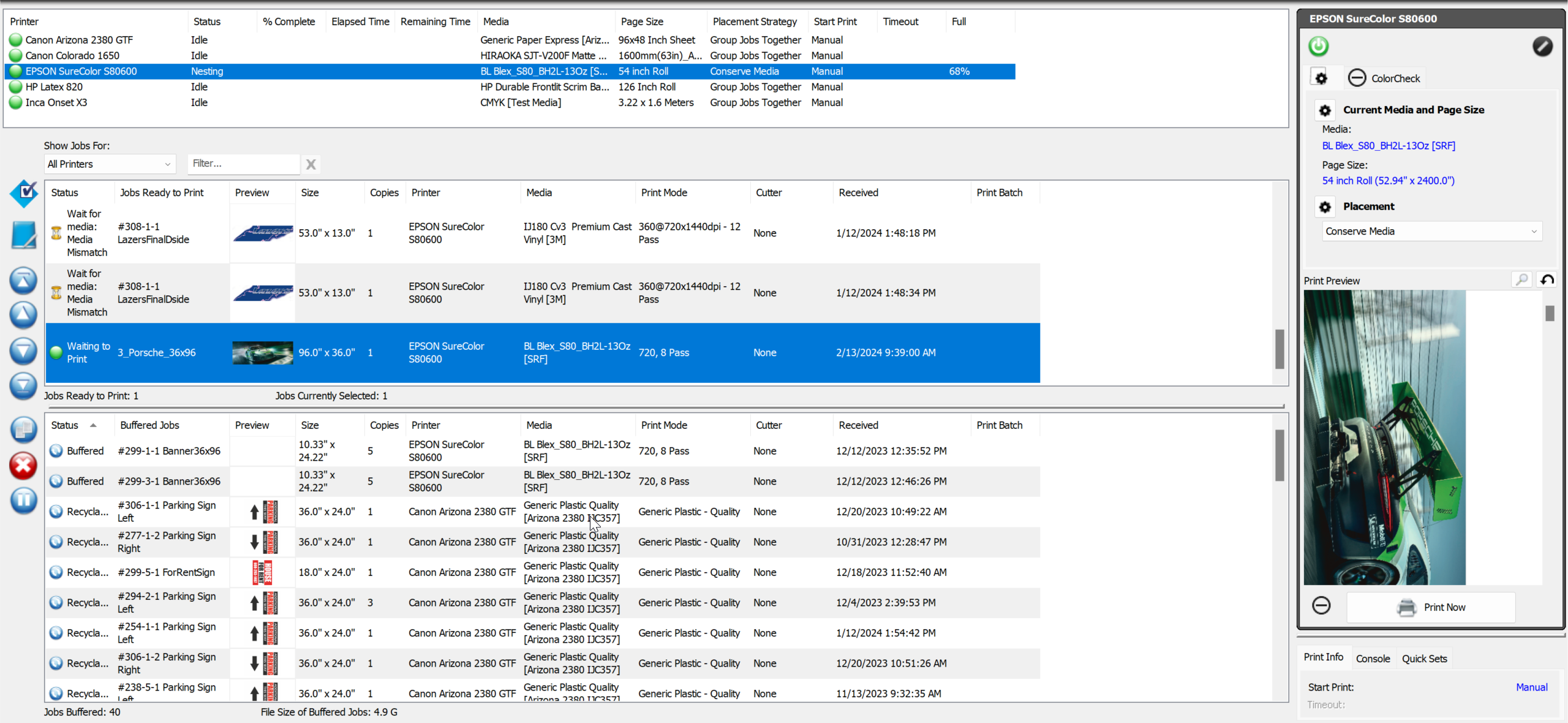

Here are my settings. This is a multipage PDF with 3 full sized banners in a landscape format at 96x36. I set the media width to 54", conserve media, and best fit with allow rotate. If I were to rotate the image in job editor, the preview image would also be rotated. Would you be able to confirm your settings compared to this?

ONYXtechtips
Grizzly makes a great point about vertical vs horizontal resolutions as well. If they are different, the system would need to reinterpret the file to determine the number of dots on the swapped resolutions. Have you ever noticed when rotating a file in Job Editor that the "Waiting for Preview" text is distorted? It is due to the resolutions set in the rotation. For instance, if the resolution is 360x360, it is a square rotation and no distortion. If the resolution is 360x720, the 720 is distorted to fit the 360 dimension during rotation and thus needs to reprocess.

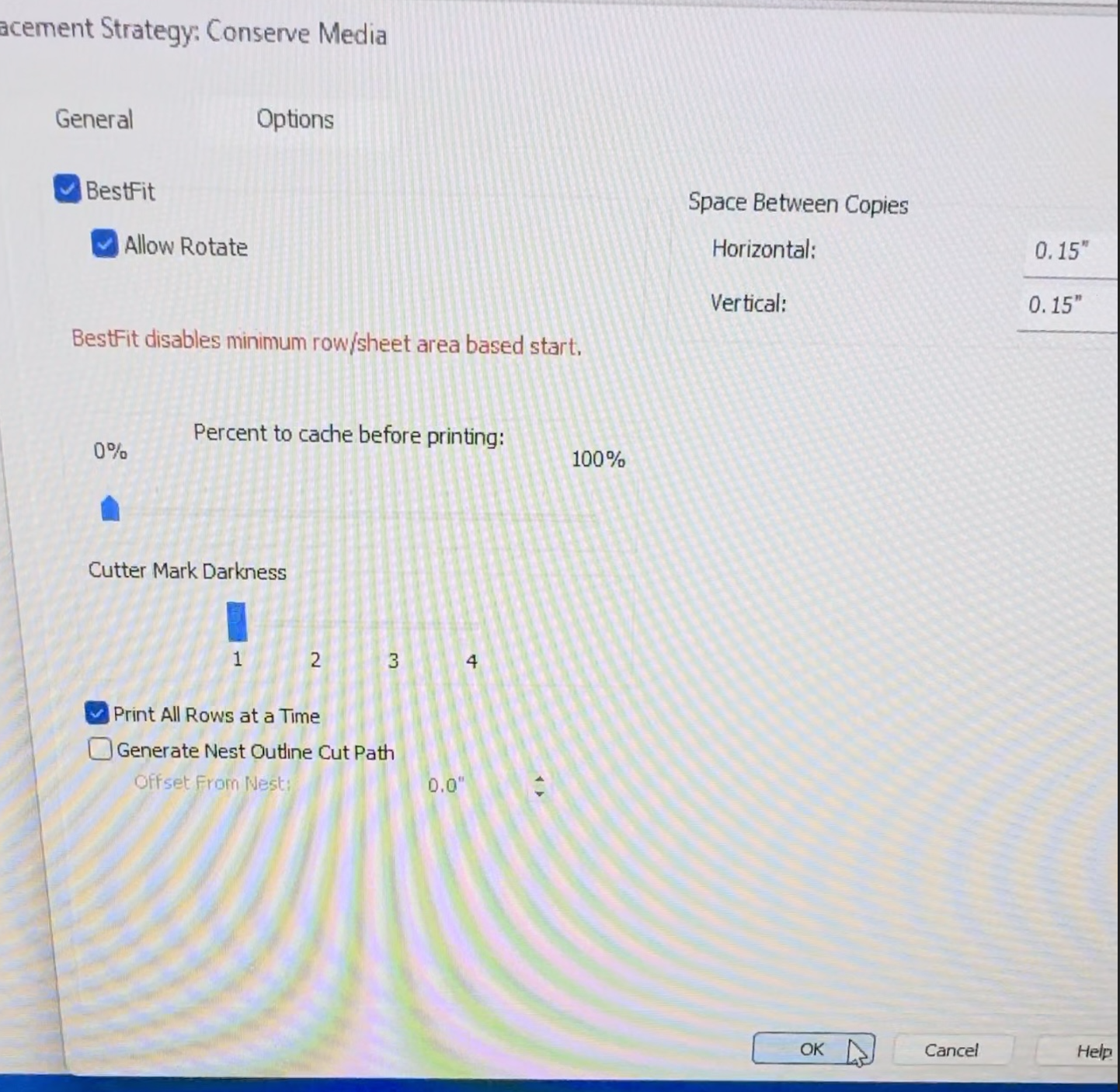

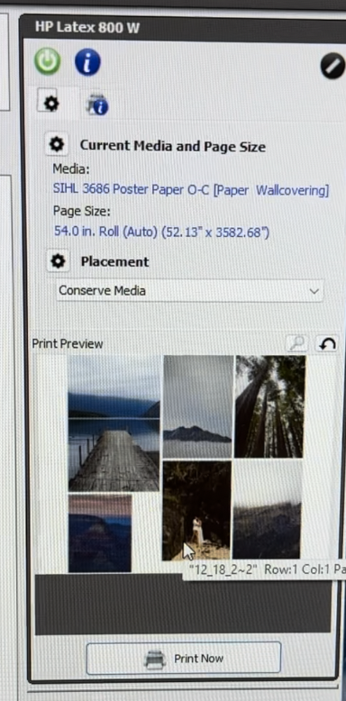

Chichia96
Here you go:
Screenshot 2024-02-13 at 11.25.58 AM.png Screenshot 2024-02-13 at 11.25.51 AM.png
