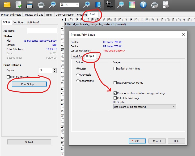

I just got my 700w and onyx 22 and im in the same boat, the check box its checked but i manually have to rotate some files to make them fit properly, even when there is room to fit more on the side onyx won't do it, it just keeps everything vertical not using the right or left sides. if i load a 24x36 it puts it vertical all the time never turns it side ways to 36".
So it appears that it is nesting correctly based on the conserve media placement strategy. What is the resolution of the media profile you are using? What happens to the nest if you change the nesting strategy?t

ozpall
Ok, figured it out, you don't need to create a new quick set, attached is a pic of where to find the setting for the autorotate. hope it helps others.

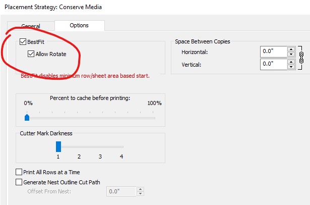

guillermo
In the placement settings on the right hand side of the RIP Queue, select Conserve Media and then click the little gear to adjust the options. In the options, select "Best Fit" and "Allow Rotate". It should automatically adjust your nest so that you would not need to go into job settings for each print job.
this option is checked and it never works.

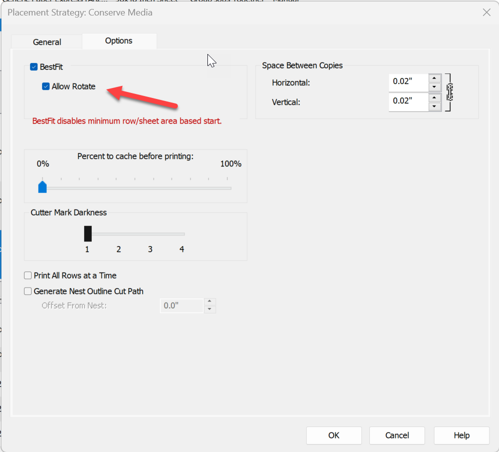

ozpall
correct, import the jobs again. and also have this autorotate selected as well.
