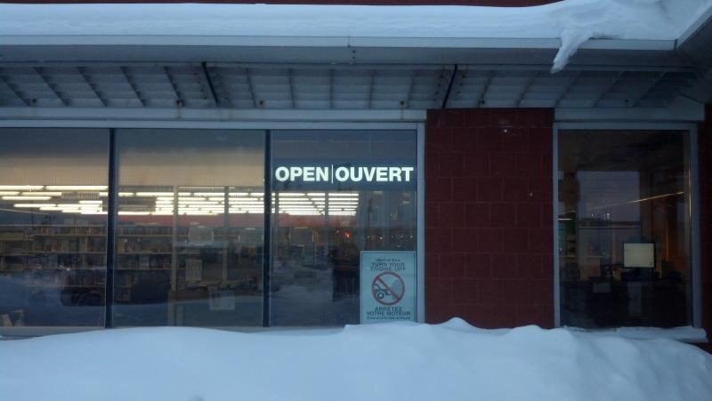

We've used Avery opaque black vinyl on a backlit acrylic sign face as the background and cut out the text so that the only part that lit up was the cutout section and the black vinyl blocked the light completely. There was no wash-out effect at all. Though I'm sure black paint would do the same thing.
Here's a photo of the sign lit up. You can't see the black background but I guess that's the point.
