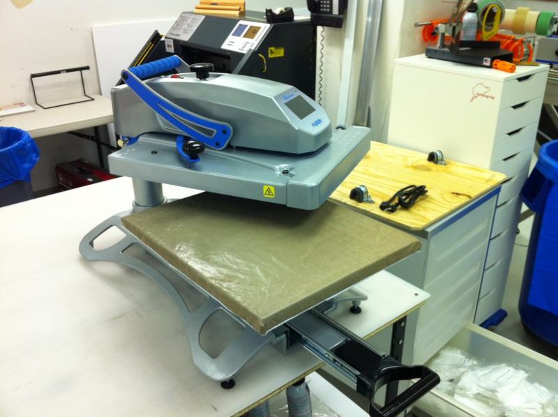

New Toy Has Arrived!
Lookie at what arrived today!! :Big Laugh:Big Laugh Can't wait to try it. Got some blanks on order. Guess I need to find some good printable media to use now. My local guys here really push the Siser product. Gotta confirm if it's latex compatible... wonder if Josh has any good latex heat press printable products?? :rolleyes::rolleyes: I got a bunch of those "cute" mini shirts to do as promo's for my customers to introduce my service. Hmmm... if I keep going like I am, I may fit into those....:ROFLMAO:
