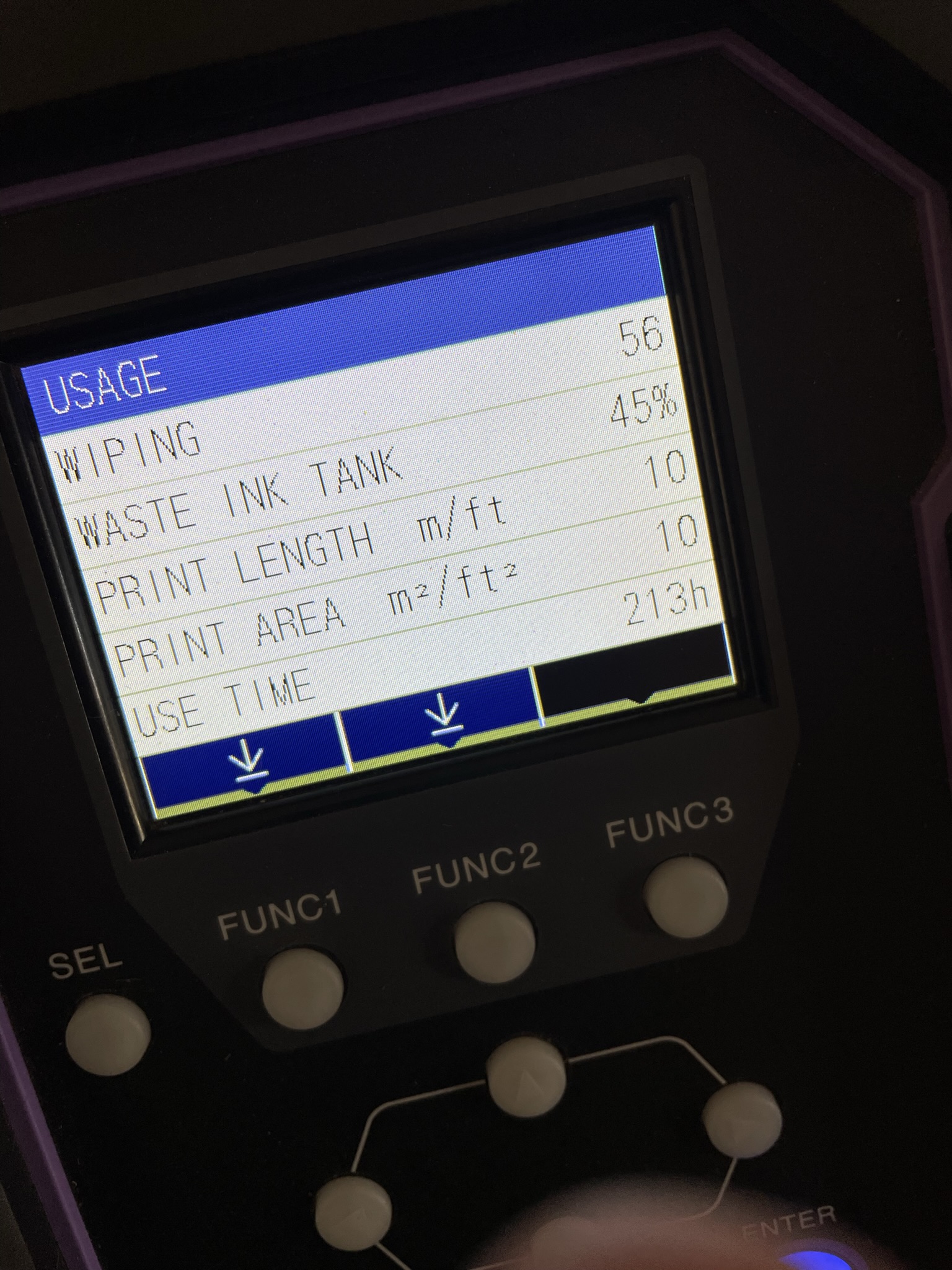

I was shopping for a BN-20a, then came across a CJV150-75. I do laser and vinyl cutting, this will be my first solvent printer.
I went to see the machine:
-it was plugged in
-there was no cleaning cartridge installed.
-all 8 of the ss21 ink expired in December
-I powered it up and it found the vinyl right away.
-it cannot print a test print (presumably due to the expired cartridges)
-the last nozzle test print that was done (presumably at install) looked excellent
-USAGE report; wiping 56, waste 45%, print length m/ft 10(!), print area m2/ft 10, use time 213h
-Version; CJV150-75 v4.0, MRL-IV 1.6, main pcb EPL3B
-I went through the error codes and I saw a 658 NCU sensor low, and a 651 replace ncu. All the rest were ink related.
The owner explains that it was installed and not used, and it sat there plugged in. The records seem to confirm.
The chances of this head being clogged are high, right?
If I'm looking at ~$1100 for 9 cartridges of ink and cleaner, what would the ballpark cost be for a head install?
Are there other 'just siting' issues I need to be aware of?
What's the best way to move this? Boxtruck with liftgate?
Thanks for any help!

Mimaki machines usually allow the inks to run for 2 months after expiration, so in reality, the machine was probably doing auto cleanings until February - of course that is still 5+ months without cleanings, so yes, the head is likely pretty dried up.
If you really want to see what state it is in, I could DM you (or the seller) instructions to wind the date back so it will at least allow the machine to function, run some cleanings, etc. In my experience, solvent ink of that small amount past expiration is not really a concern.
It is most likely that the machine will need a head, which would run you about $3200 for the original Mimaki one (comes with 90 day warranty if installed by an authorized tech). Dampers will be OK if they’re still entirely filled with ink. Cap probably OK.
Current price on this machine in US right now and s $8495 (plus freight and install), so you definitely want to make sure you’re getting it relatively cheap if you have to drop a head in it.
If you do buy it, yes truck with lift-gate is the easiest but as it’s a small machine, with a couple of helpers pretty it’s easy to pick up. The low-floor Uhaul 10’ Box Trucks are and easy way to move these. Leave the cartrides in an secure the head over the capping station to prevent any leaks or damage and secure against the wall-rails of the vehicle using ti-downs.
