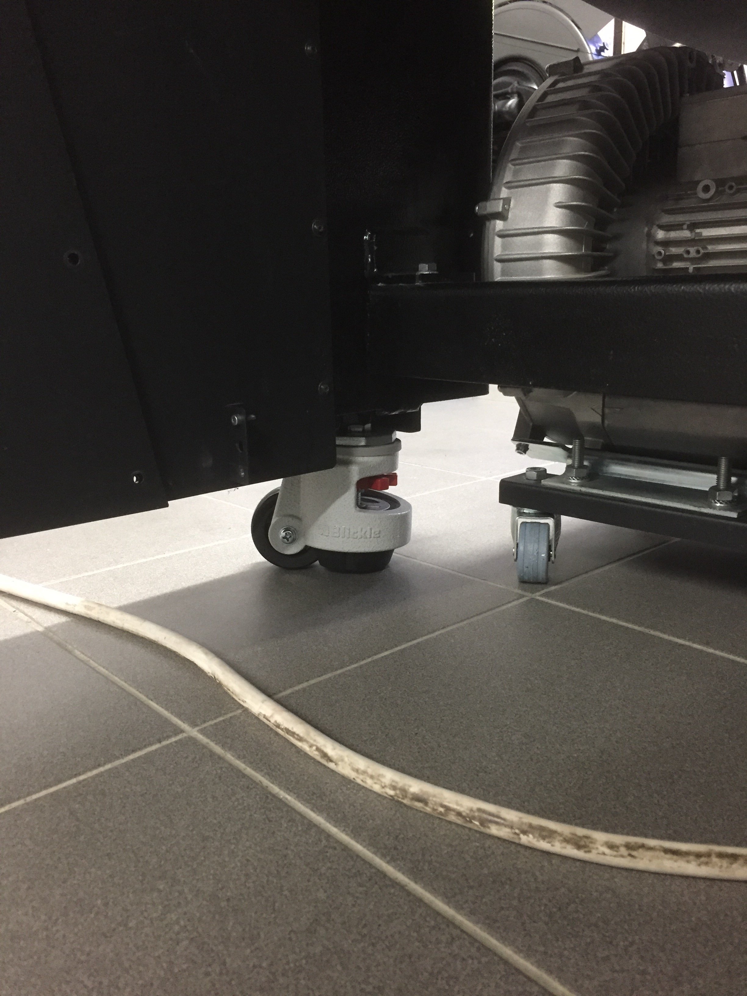

With the new GoProduce software it is even more fun to work with it! the workflow is twice as fast in my opp...
We allso added some blickle wheels, because the shop is small and we need to move the machine time to time.. (allso the pump is on rollers).

Love this! Our shop is also smaller and my biggest concern is compromising our workflow and space by adding one of these units. Does it require much work to re-level the unit after you've moved it around?
Do you drop it down onto the "feet" or do you just leave it with the wheels down? Our Oce flatbed has these but I've never moved it in fear of it not being level after.
Do you have the specs on the wheels you bought? Did Summa or the tech have any concerns about using these?
Thank you!
