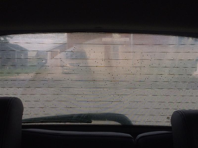

I use 290GF and 297 (thicker, less squeegee strokes) for a while but it doesn't last very long. I made 2 delivery cars for a local pharmacy like max 2 years ago (maybe less) and backglass is completely ruined. Many holes (cells) are perforated so dirt is trapped everywhere + the whole film has turned "foggy / fuzzy". 'Will have to replace 'em. 'Haven't had better luck with other brands so I stick with Oracal.
At the beginning, it's normal for few weeks that the film is not perfectly clear as expected. I figure it's the time it takes for the adhesive to set and gloss from behind in the holes. It may also depends where you live. In Canada, we can have like 60-70 degree in difference, it's quite a range! (winter -30°C / summer +35°C)
Sure there's a benefit to laminate, the 1st being protecting the print and in second place, keeping dirt & water away from open holes to "See Through" but unlaminated window are just perfect for those who wants to see it in 4K (...)

Here's what I talked 'bout...

Rarely see problems / comebacks when installed on pickups' rear glasses. Usually it's on angled cars' backglasses... I always told owners to take off the rear wiper fuse... part of the dommage is directly linked to "sandind" done by the dirt laying on wiper blade... When used in heavy rain, it has no real effect but I figure it's mostly turned on when windows are covered of dust / dirt / bird drops...
