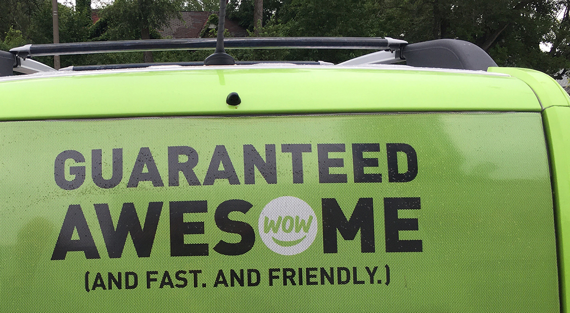

3M 8518 has a synthetic liner like Oracal's 290 so basically it could be fine to use it ('never tried)
290G and 290GF is the same film except the release liner. If it's good for Oracal, chances are 3M figured out the same formula...
Wow no... the liner doesn't make it optically clear. Hold up a peeled off piece of 290 and 290GF and you'll see the difference. 290GF is clear. 8518 is super murky when you look through it.
