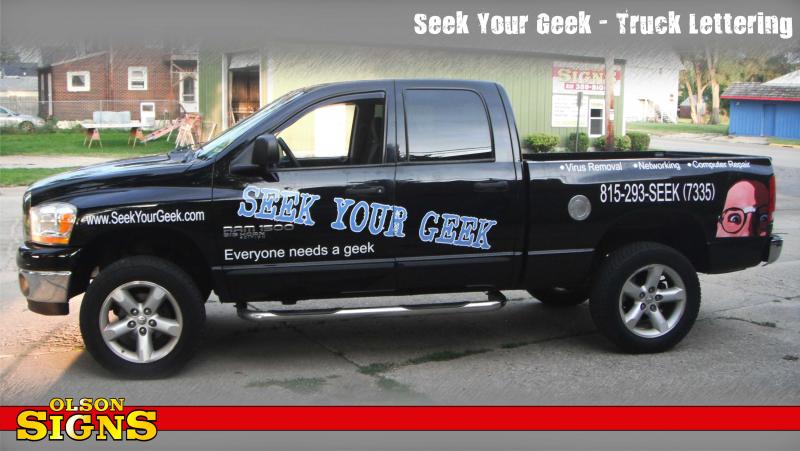

We've used 651 and still do.
Trucks that have been lettered with 651 still have the vinyl on it, its not falling off or faded.
However: It does show some small cracks in spots like where the points meet on some letters such as the E & T. My guess is that since it did shrink a little that it started to pull a little causing it to have some hairline cracks.
This is based off first hand experience as we just removed the vinyl off the truck as our customer is getting a new truck and was happy with how well it held up.
751 is better yes, but it does cost more. $100 more per 50yrd roll.
Here was the truck:

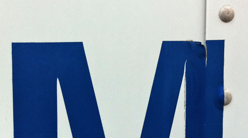

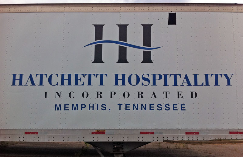

I used 651 on these trailers. The first ones were in 2001 and the last were in 2005. I randomly came across one of the trailers last fall and snapped these pics.
thinksigns, i use 651 on similar job and i have had that same issue so i started cutting the letters on the edges of the alum panels. they may shrink a little but that's as bad as it gets. it doesn't pull up like in you pick.
on the 651 i use it all the time and no issues except on the hoods of trucks. between the sun and the engine heat they last about two years. on the sides i have jobs over 5 years old with no issues. all jobs will vary depending on weathering and pressure washing
