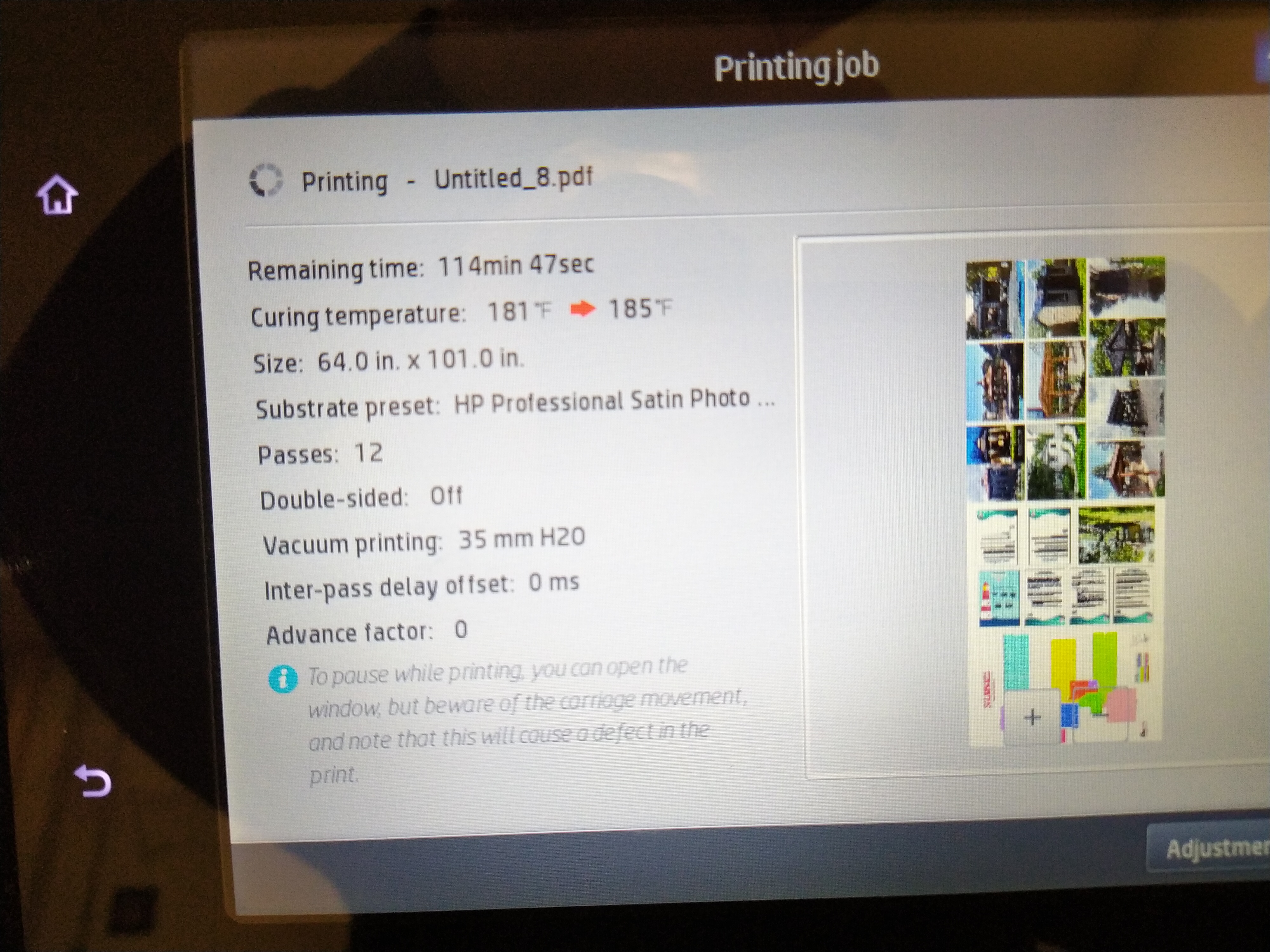

I ran a few jobs using up a few 150' rolls of media. When I switched materials and ran a small 30" canvas the printer caught me off guard and was about to "print" another 80' of nothingingness.
I checked the original file, the Flexi page, the PM and everything I thought of to see if I had added something, or missed something and I came up blank.
Has anyone encountered this?
JamesLam
Here's a pic and a few things stand out.
First is that the media is 42" wide, not 64" as shown.
Second, the print shows as being 101 inches, which I think is close to the actual length of the job yet the time for printing is just under two hours.
Any thoughts would be appreciated.

JamesLam
This comes from RIP.
I have printed who knows how many full rolls and I have only seen this a few times during the past week. As suggested there is definitely a lag or disconnect between the RIP and the printer.
Could it be the computer is not powerful enough to keep up? Do we need to clear out a cache?
