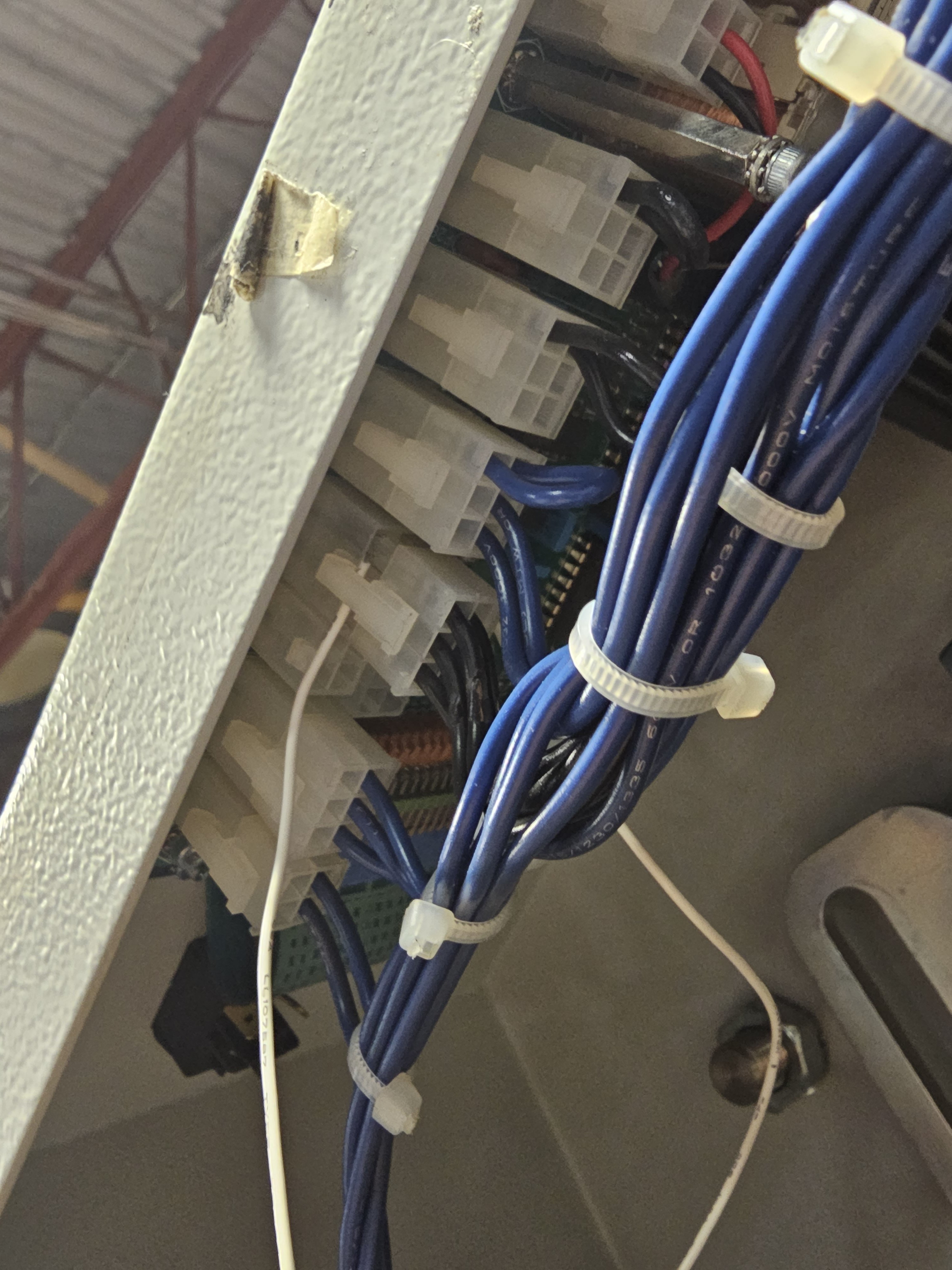

All you have to do is jump the top two wires wires on the 6 pin molex like below - in my photo, you'll see a white wire running to both. We just spliced a cable, shoved it in and replugged it in... That keeps it always open and it'll never trip. Again - do it as a temp measure for testing only. I do not recommend running it like this for long.

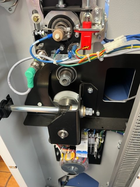

Dan Berg
I have the Seal Base 62 and neither of my open end panels look like this.
ikarasu
Look up, it's attached to the speed / snail dial.
Mines a seal 54 base, like 15 years old... So they could have made revisions, but Id think it's the same.

The optical sensor is the chrome device with the fetching green cap, attached to the top roller mounting plate. First time I had one fail, it was a £100 part, and took half an hour to user replace (different manufacturer, almost certainly same family of part).
Second time I got stuck in bleeping snail mode, I still had a red light from one side, but there was an aperture disk in front of one side, that seemed loose. Took it off, and had connection, until a foreign object was placed in fron of rollers, at which point, bleeping snail. Might be worth having a look, and equally, relaxing the mounting of the Tx Rx, to see if there is just a subtle out of alignment issue.
