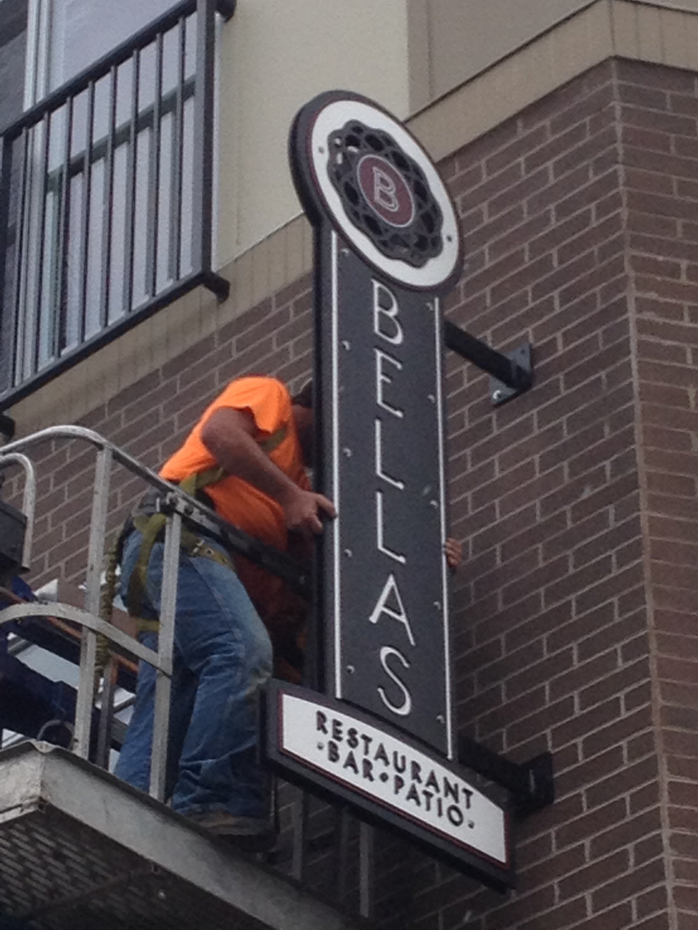

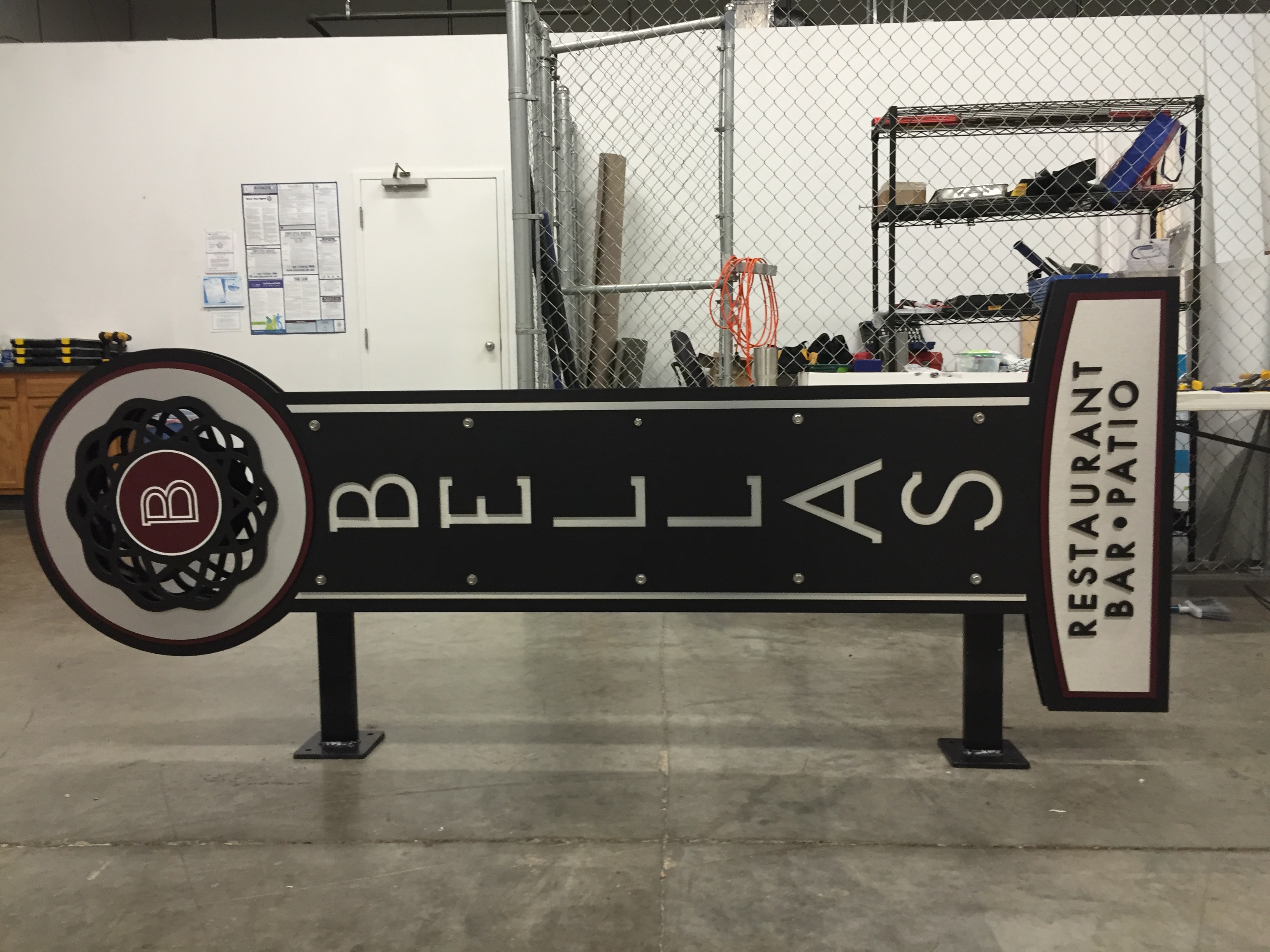

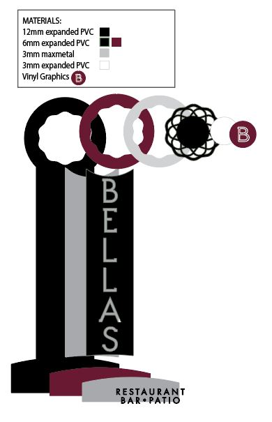

Painted PVC and ACM sign for local Italian restaurant. I used Weld On and nuts, bolts, washers to hold it together.
