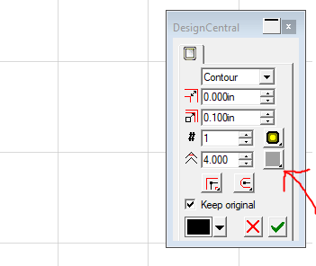

Weird one. not sure why this is greyed out and I no longer have the option to change this. So when I create an outline, it will fill the shape.
I can't click this box to change it. I used to be able to.
help? Thanks :)

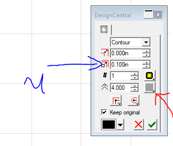

after banging my head for days...... i made this post. fiddled more and found my issue. DUMMY.
Posting this for others in case they ran into this
Blue arrow. make 0.
