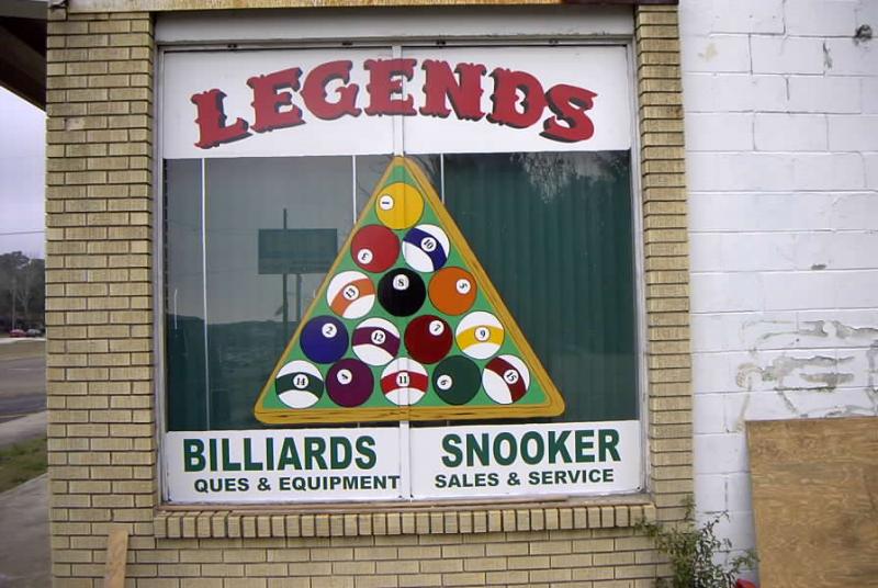

this is a window i did........in the 2 colors your not supposed to use next to each other..THE LEGENDS is all paint, as is the pool balls, the lower green is all vinyl.

Using OldPaint's example, the drop shadow looks good, except for the way it's done in a perspective toward the centre - that would not have been common on western signs. Obviously the text in Arial at the bottom wouldn't have been available in that era.

Is that a rack I'm not familiar with? Most 8 ball racks have the 1 at the apex, 8 ball in the center, and a solid and stripe at either bottom corner.

Why do you assume 8 ball? There are a variety of other full rack games, mostly unknown to barroom pool shooters. Straight pool and one-pocket where it doesn't matter a whit where any ball is racked, rotation where the 1 ball should be at the front, 8 ball where the 8, a solid, and a stripe should be at the center and a solid on one corner and a stripe on the other, as well as a host of other games.

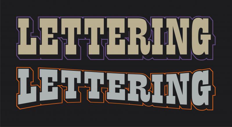

I like to take advantage of a "free" color when lettering on black, with an outline and shadow. Shadow sample jpeg.jpg

Hence the reason I asked. I'm not familiar with those games. I know most bar pool shooters go solid-stripe-solid-stripe all the way through the rack, which is unorthodox by most standards. Then there's regulation 8-ball, which I am vaguely familiar with as I haven't actually played in probably 20 years, but I remember the general gist of the rules. It's interesting to know there are so many games, but wouldn't regulation 8-ball and 9-ball be the most prominent? Not that it's relevant, I'm just curious.

Only the 3 and 13 need to be switched to create an "official"
tournament 8 Ball rack. After you fix it, post another picture
so we can all get some rest. Kudos that you can still hand paint.
OldPaint
i did 2 of these windows. one got busted during hurricane IVAN(2004)so this can tell ya HOW OLD THIS IS))))))
as for the QUE.........owners choice(and he was from NEW ORLEANS...cajun french))))))........he thought it was funny...so do i.....as for the positioning of the BALLS..... in the rack...........only rules i ever went by for an 8 BALL RACK.............8 BALL CENTER.........STRIPED BALL ON BOTH BOTTOM CORNERS!!!!! the rest dont matter. i grew up in a bar, was shooting pool from 10-12.......in PA. and like the spelling is never done by others))))))
