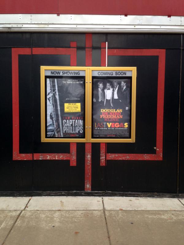

Attached image shows current wall on our local theatre. I need to redo the wall with the red and black design.
Questions...
1. Use my normal outside sign material and lam and print the black and red?
2. Buy solid black roll and red roll and place that way?
The wall is 6'5" tall and 30' long. Thanks.

MikePro
no way vinyl is gonna outlast paint, if done right.
i only ask because at 6'x30', that's a heck of a lotta vinyl application to what appears to be ...a concrete wall?
...and then to double to cost by printing, because you have to add laminate.
paint the black. print/lam red striping on concrete wall wrap vinyl.

Thanks MikePro. It is actually wood walls that they filled in the screw holes.
player
Super prep it with sanding and sealer primer. Do everything overkill. Should not give you any problems.
You could redue the walls with Alucabond or similar aluminum sandwich material. Then use red vinyl tape.
