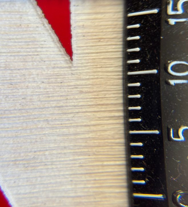

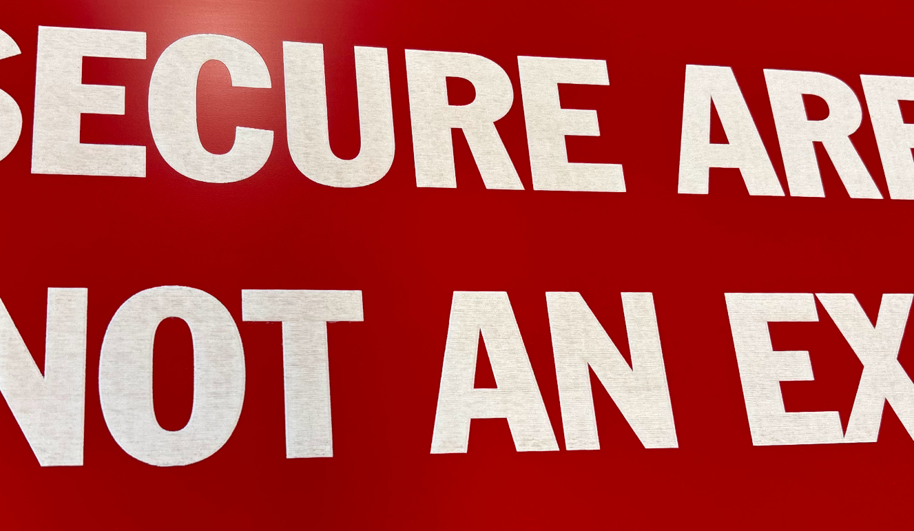

We had a company make this sign for us. I think this looks really bad. I can just barely see the texture from 8 ft away. CLoser in is bad. Even far enough away it looks like a dirty white instead of a white, I'm guessing because of all the little shadows. My partner is like don't worry about it. Is this really what I should expect from laser engraving? I didn't realize the quality was so different from CNC routing.
Close up - units in mm.

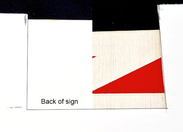

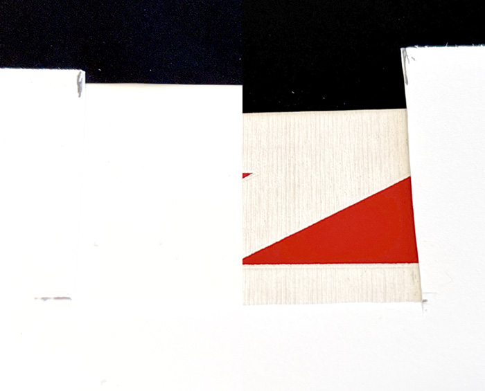

Brightness and color of lasered areas vs back of substrate (black vinyl and white paper to normalize the brightness and contrast)

We engrave tons of these signs, this is absolutely not acceptable, red/white material needs to be engraved twice to remove the pink staining from the text. Also the texture is indicative of running the laser at a low dpi to lower the engraving time.

Yeah that would not pass at my shop. The engraved part should be smooth and not show the lines. Red with white has to have 2 passes and usually we engrave from the bottom up so that the exhaust isn't passing over the already engraved part. Makes clean up a lot easier.

Oh, I thought it was a brushed texture and that it looked fair, just dim where the brush strokes were.

Every line it moves down has to be smaller than the diameter of the pin in order to get a flat surface.. Usually isn't so you get raised parts where the engraved lines don't meet, so by doing two passes you then break that into tiny blocks. Best way is to slightly defocus the beam so it's now bigger and passes overlap.
Where as a Cnc cutter can have a flat base and large diameter so the passes can be further apart and it's faster and flayer..

I also engrave reds bottom up. I also do this with browns and darker blues in addition textured 2-ply plastics any color. There is also Ultragrave by Romark Plastics that require 2 passes to keep the engraving clean. Although I have a special profile I created to do the second pass as a "clean out" that uses less power. I find running a second pass at pass 1 settings is a little aggressive and engraves too deep. My clean out pass uses 25-50% of the 1st pass power setting and works every time. Air assist helps with these colors as well.

How 'new' was the company doing it? This looks like the work of a total amateur who doesn't know lasers nor substrate oddities.
