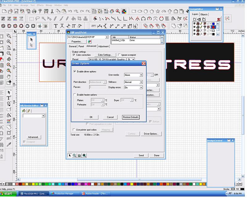

For a backlit sign - I need to put down two passes and I thought that was in the driver options menu - here is a shot. Thanks guys.
