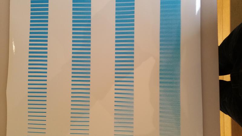

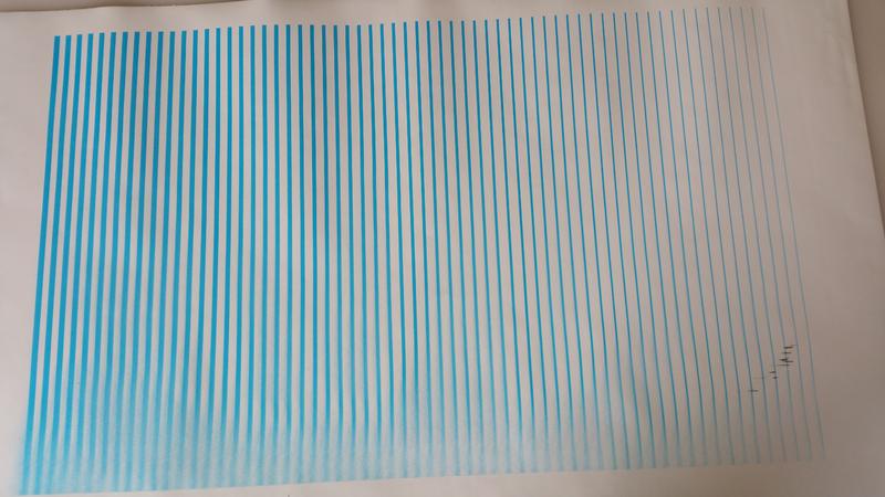

I fitted a new Cyan head about 6 weeks ago. Alignment etc all seems good. The new head printed sharp and strong immediately.
Somewhere in the last few weeks I've been getting overspray from the Cyan head - Only when I first turn the printer on - (but the nozzle print is perfect)
If I run a few 100% Cyan prints the overspray clears up completely.
Any Ideas.?
Its a JV3 160SP Running Inktek full Solvent

More weirdness........ Switched the printer on about 3 hrs ago and left it innactive. Just tried the same test print and the Overspray is massively reduced...?

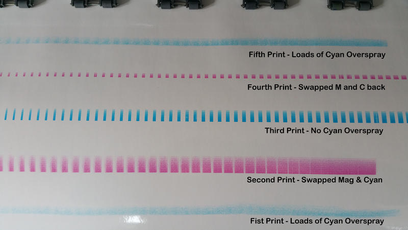

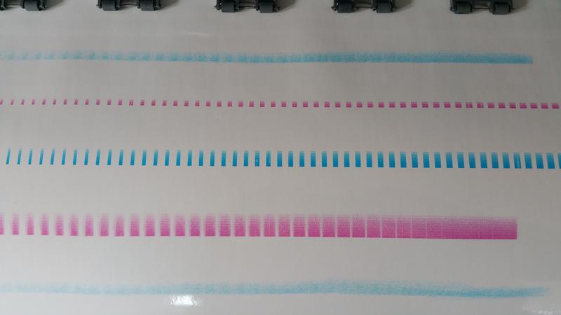

Its looking like it's the Slider Board. I swapped magenta and cyan over at the slider board and the overspray issue moved to the Magenta head. It's just odd that after printing about 300mm of overspray the head starts working perfectly. And then runs fine all day...?
Thanks Mike for the help...
