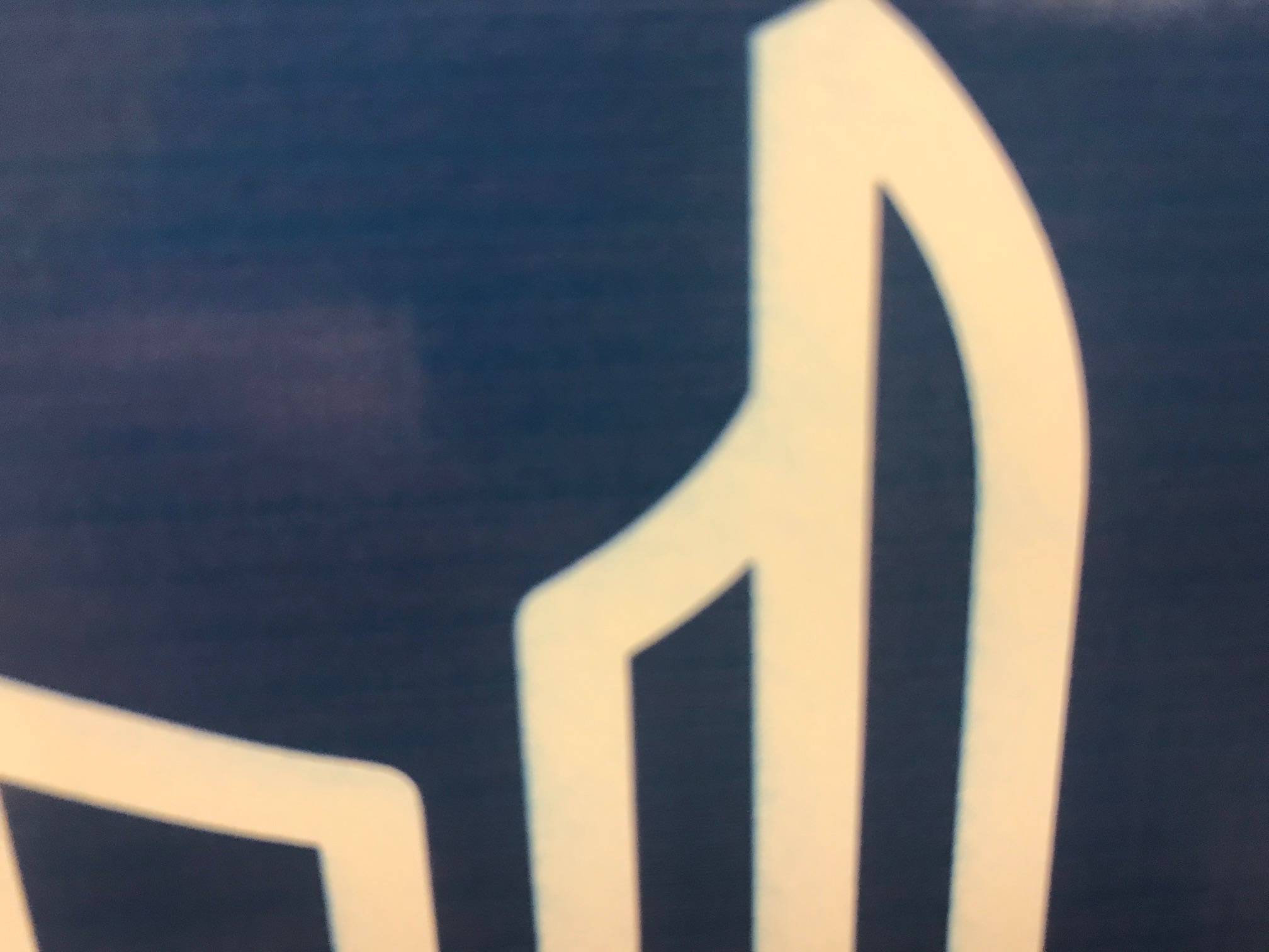

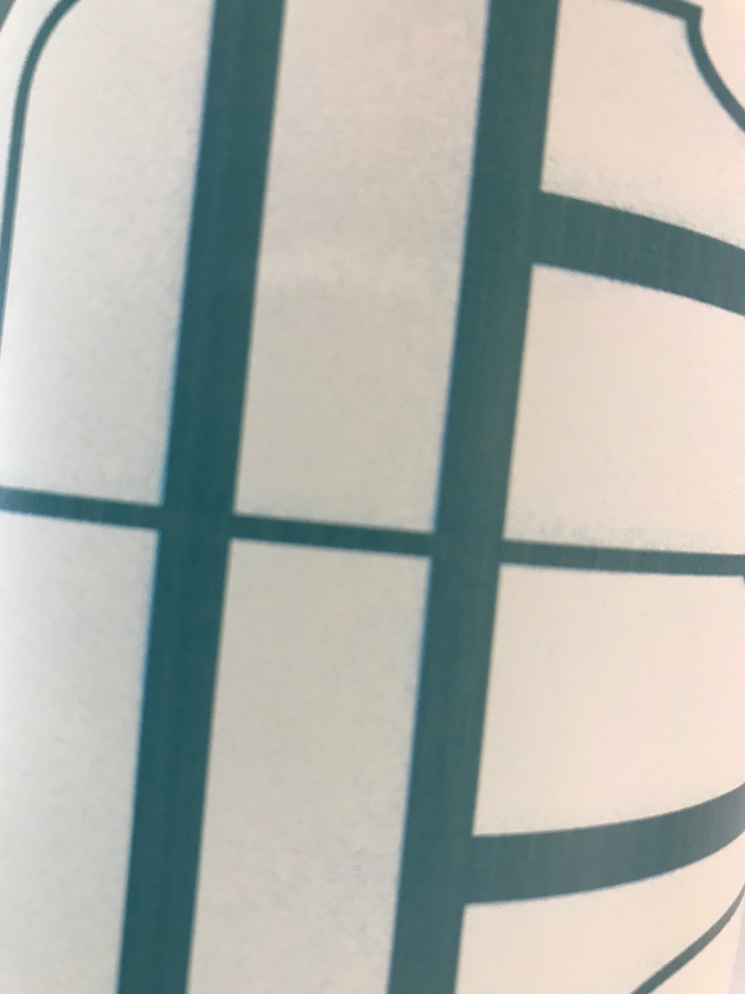

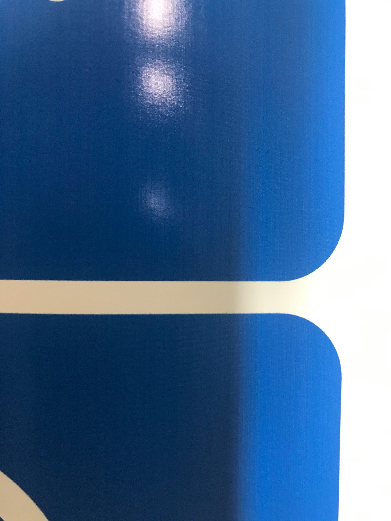

Here are 3 pics...2 are pretty blurry and those are the ones with the overspray, yet this handicap decal I printed today is absolutely clean!! Strange but true
